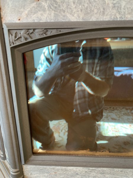

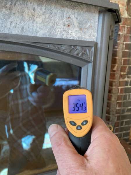

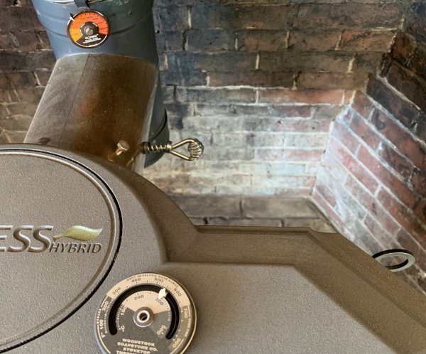

    It was cool and windy today, and I took a few notes. Our PH is on a 32’ chimney, it has the modified damper, and has a pipe damper. I loaded it (not stuffed full) with Red Oak and Red Maple. Once it got going I closed the bypass, and about 10 minutes later I started closing the dampers. The firebox flames went out - usually we get backpuffs withon 15 minutes, but the draft extra strong, so I left it alone.
    At 9:06 it was STT 545, probe at 600, firebox dark. I fully closed the dampers. You could hear a hum from the cat burn.

    15 minutes later it was STT 615, and climbing, and the probe was down to 520. There was a strong hum going on. Given how fast the temp was climbing while all farmers were fully closed I bailed on the full-cat burn and gave the firebox some air.

    Another 40 minutes later I had STT 510 and probe at 400, secondaries rolling, and the hum was gone.
    In another half hour it was STT 450 and probe 350. Draft controls back to fully closed.
    And then another hour later, STT 360 and probe 200.
