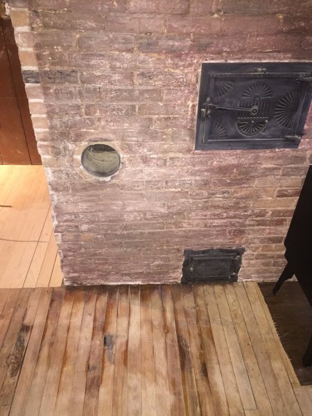

  2. MJK Farm
    MJK Farm
    Sep 10, 2017
    67
    303
    Maine
    There is the 6 in. flue connection. The stove that was there before (which I intend on using in another room) is a 1890's Penn Franklin coal stove which exhausted out the back.
    Note the forlorn pleasant hearth leg in the right of the picture!
    wildwest and Thor like this.

  5. wildwest
    30,148
    141,408
    Wyoming high plains
    What are the doors in the wall?
    HDRock likes this.

  8. MJK Farm
    MJK Farm
    Sep 10, 2017
    67
    303
    Maine
    The large door is a pizza oven with an opening for the smoke to go and the bottom is a clean out.
    HDRock and wildwest like this.
