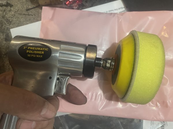

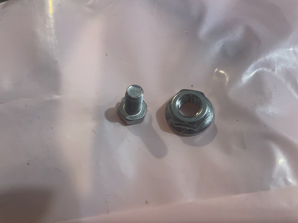

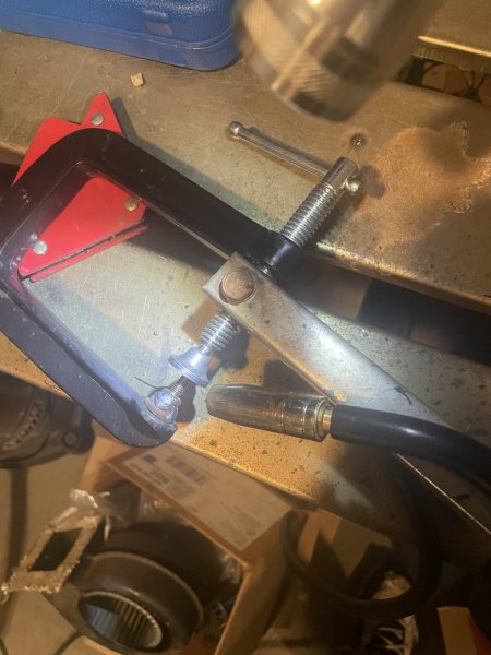

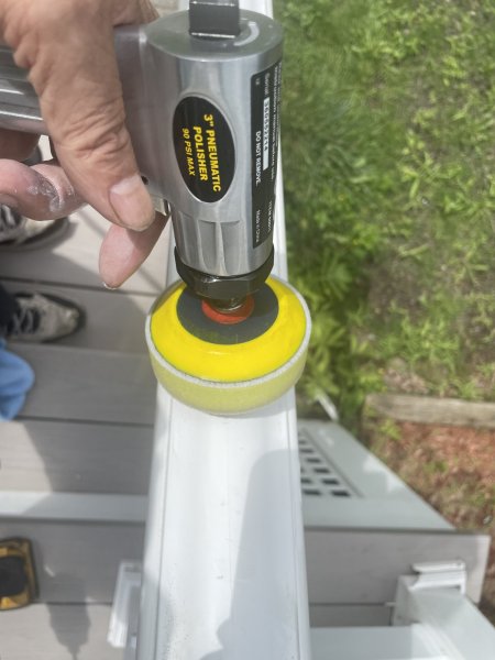

    I found a 1/4x20 fine thread bolt and a 5/16-24 fine thread flange nut and welded them together to make a “Nut Head Bolt” then screwed them together with lock washers! Works great! Now this old polisher is compatible with the old and new polishing pad kits!!

    Pic 1 - Air Polisher - 1/4x20 Bolt - 5/16-24 Nut - Polishing Pad

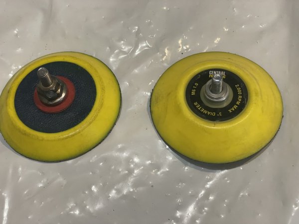

    Pic 2 - 1/4x20 fine thread Bolt - 5/16-24 fine thread Flange Nut
    Pic 3 - Welding the top of the nut to the head of the bolt.
    Pic 4 - The new Nut-Head-Bolt
    Pic 5 - Bolt is installed in Air Polisher with 1/4x20 lock washer
    Pic 6 - Polishing Pad screwed into 5/12-24 fine thread nut with lock washer.
    Pic 7&8 - New polishing Pad Kit part # 58187 which is the same Part # as the old kit with the pads that fit the polisher!
    Pic 9 - Old polishing pad kit

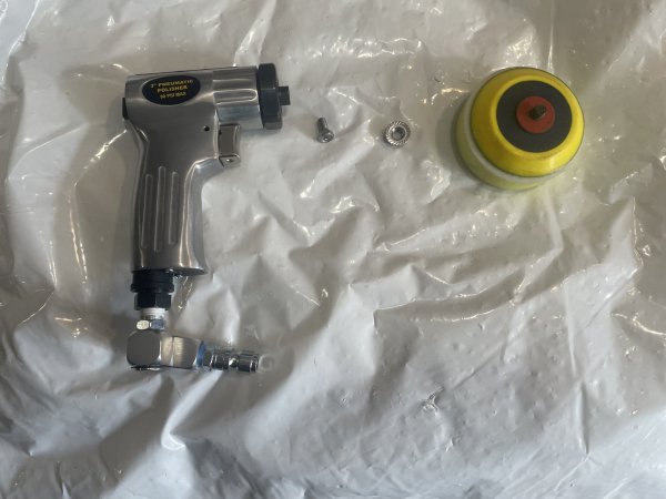

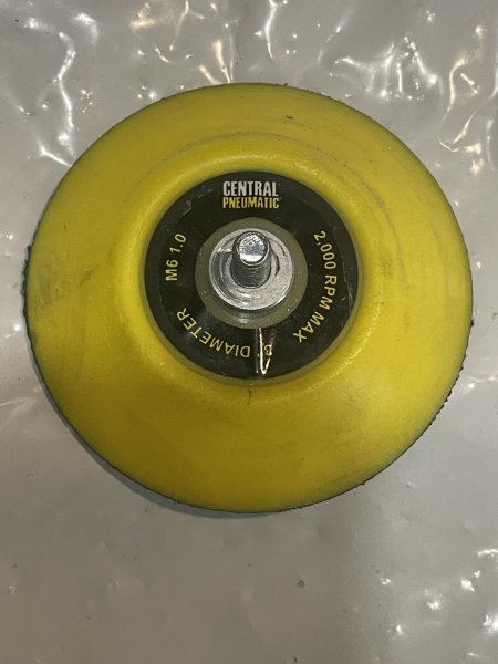

    I actually found the old Harbor Freight buffing kit. Same part # 58187 and it has one piece with the 1/4-20 fine thread (M6-1.0) and Velcro which will attach to the new buffing kit. If that piece is not availabke Then welding a Nut-Head-Bolt will work as outlined above. :)
    Does anyone have a newer air polisher with the 5/16-24 Shaft or hole for the new buffing kit?
    Pic 1 - Old Kit Air Polisher Buffing Pad attachment. 1/4x20 fine thread attached bolt shaft (M6-1.0)
    Pic 2 - New Kit Air Polisher Buffing Pad attachment. 5/16-24 fine thread attached bolt,
    Pic 3 - New attachment with Nut-Head-Bolt left and old Attachment that works with air polisher as is.
