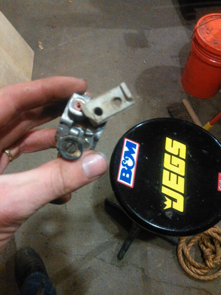

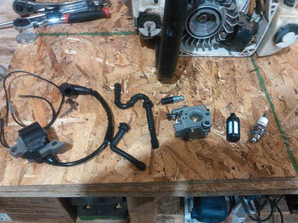

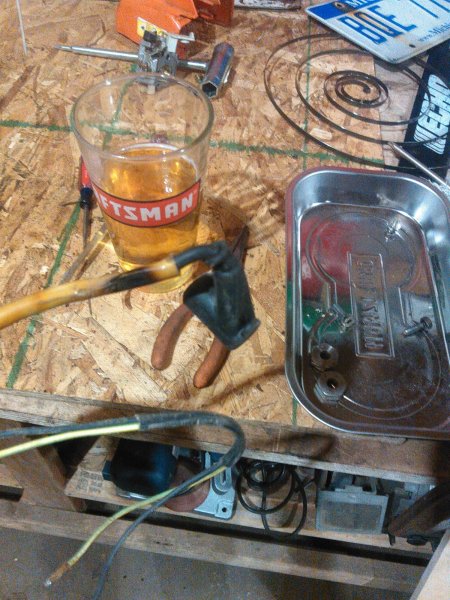

    The plug boot and wire as well as the ground where routed wrong and melted so there ya go found it... The kill switch wire was also pinched. :headbang:
    I took the old carb out and installed the new one as well as removing the epa limiter off the high screw. The spark screen looks like well solid metal so its gone and im now opening the muffler a little too. 14511656618871091343708.jpg 14511657104281208417371.jpg

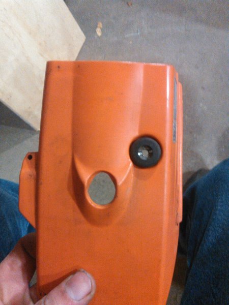

    The decomp cover is so warped ive had to cut the hole for the decomp button wider but it works! :)
