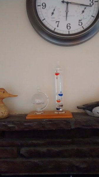

    I confused which gal here had the galileo thermometer, was that you?
  15. Firebroad
    Firebroad
    Jun 13, 2014
    931
    3,727
    Finksburg, Maryland
    Not me
    But I got a water one.

    I think they are both Galileo. (?)
