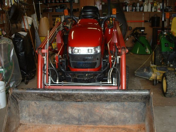

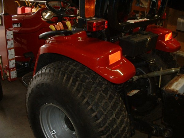

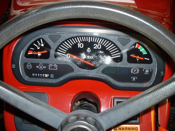

    I just bought a Case DX33 with L130 loader for use in my apple orchard. But since I have this, it might work pretty nice for firewood too. I just ordered a quick attach bracket for the loader so bob cat style implements can be easily used. Will get pallet forks first thing DSCF0003.JPG DSCF0004.JPG DSCF0005.JPG DSCF0006.JPG
    What I am contemplating is a box that can be picked up with pallet forks. Wood would be split and thrown into the box and then taken to another spot and stacked. The bucket itself is not near big enough for this. The size would be so that it hold 2/3 of a face cord, aprox. 40 cubic feet. ( matched to carrying capacity of the loader)
    Right now I have the rounds stacked, the wood is split and immediately restacked but his is really slow when using the capabilities of a 4 way wedge. Letting it fall to the ground is a hassle having to pick it back up.

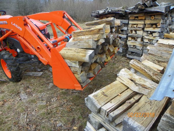

    On carrying wood in the bucket, don't be afraid to overload it. I've seen lots of folks load only to the top of the bucket but you can keep on stacking. I've posted a picture to show what I mean but I've stacked a lot higher than that. This load that is pictured I took about 1/4 of a mile. Just have to go slow but one needs to do that with a load on the front anyway unless he wants to change bearings a lot.

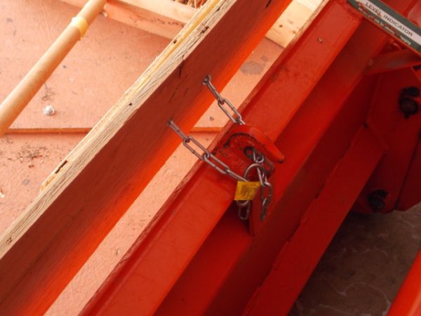

    top picture center looks like a chain thru the wood?

    I went back to the "tractorbynet" forum and found the pics again... It is chained on..
    The original poster in that forum never went into detail about how he built it, just these pics...
