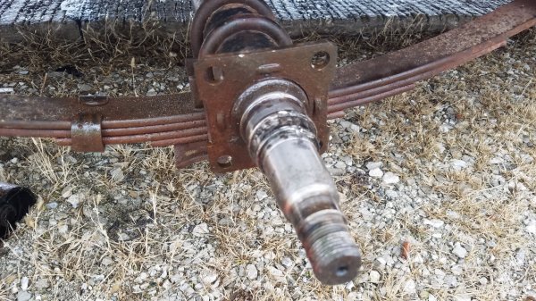

    I got a 6x12 3000lb axle with slight bearing issues....she would be cheap lol.
