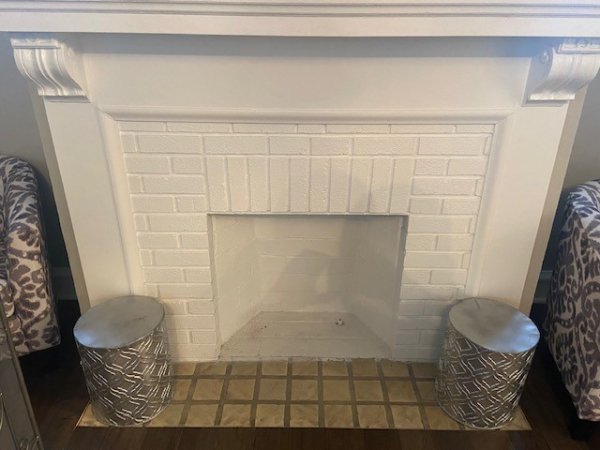

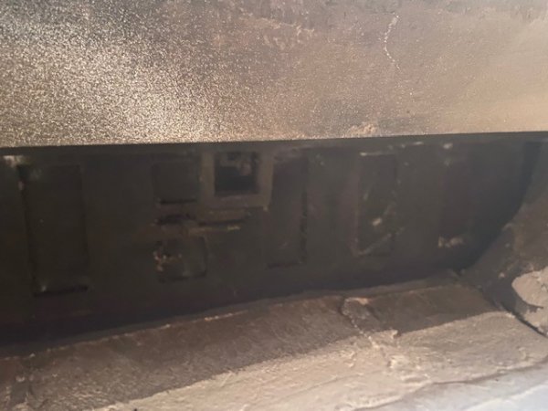

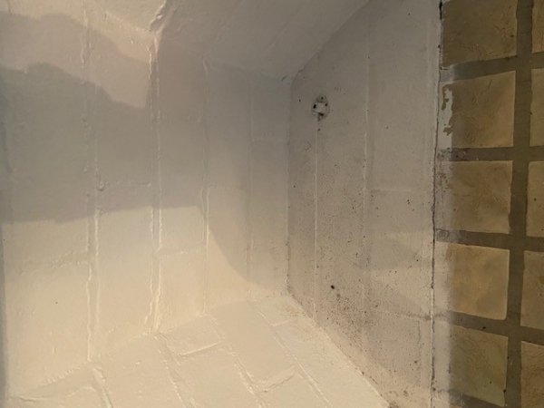

    Picture of the firebox and damper in my living room. Firebox and flue size are both tiny. Firebox depth is 12", height 26" and width 26". Like i said, I've had a lot of folks tell me on other forums it was not uncommon to have gas inserts back in the 1920s and not a wood burner - i was surprised to learn gas was available back then. Chimney sweeps have also said not a wood burner.
    So, not sure if there's really anything i can do to get a wood burner w/o a lot of demo and rebuild? Wife said "no" to wood insert if that's even an option - she doesn't like the look.
    My basement is unfinished and sounds like this would be problematic. I should point out, this won't be primary heat source and is mainly for the fun of it/coziness. I have a decent amount of open space in the basement - so I was thinking perhaps down there would work - but then the venting sounds like an issue. Currently have the hot water and furnace venting into the chimney in the basement.

    You will need to know the size of the flue from the firebox up to daylight. Most stoves need a 6" flue to vent.
    If large enough, consider an insulation wrap for a liner if the integrity of the chimney is in question.
    As far as combustibles, is any of the trim around the fireplace wood? If so, heat shield may be needed.
    The paint on the brick and surround may be an issue as far as flaking, softening with heat.
    You would most likely need a hearth pad under the stove that would extend, depending on code 18" in front of the loading door, and possibly a few inches wider than a stove.
    As far as stoves, the 2020 EPA regulations took a lot of stoves off the market.
    Jotul still makes the 602, which is a little long and would stick out into the room.
    If you could find a used Jotul F 100 or F 3, they are smaller stoves that can be rear vented and a flex liner run straight up from the tee.
    The flue size that you have now is probably going to be the biggest determining factor of what can be done.
