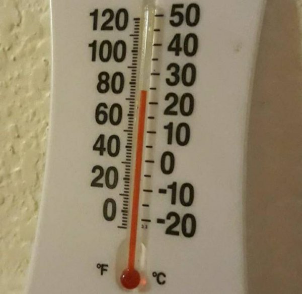

  10. blacktail
    blacktail
    Mar 4, 2015
    1,455
    10,045
    PNW
    We're in the same region, same weather, same wood species (mostly). Here's what I have.
    1155sf house
    Lopi 1250 insert (1.6cf)
    Exterior brick fireplace & chimney at one end of the house
    Uninsulated 15' liner
    No block off plate
    My blower is usually set at about 1/3 speed.
    Would a block off plate help? Yes.
    Does my insert heat my house well enough as is? Yes
    My insert handles over 90% of my heating and the cold weather this week was no problem. 25° outside and I was wearing shorts inside. This thermometer is in the middle of my house. 20200117_171644.jpg
    Chaz, Horkn, Marvin and 4 others like this.

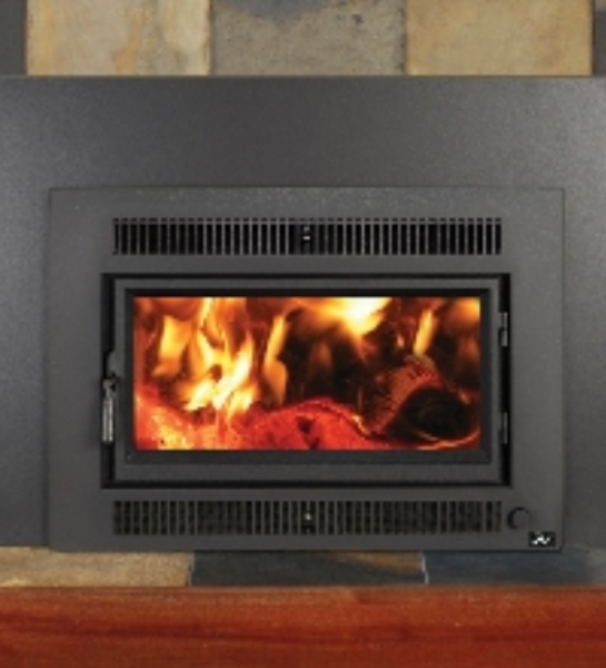

  15. Horkn
    27,966
    157,346
    Is this the insert? And is this the surround you got? If so, you should be able to easily add an aftermarket blower like the one I bought.
    Fireplace Blower - 150 cfm
    Chaz, Marvin and FatBoy85 like this.

  17. FatBoy85
    FatBoy85
    Feb 25, 2017
    6,592
    25,100
    Washington State
    Thanks Tom!
    Yeah that’s actually the Catalytic version while mine is the Arched. I’m just leery of buying a 400 dollar fan when I had hoped that the heat would be radiant enough to heat what is probably a 1000 sf downstairs. The upstairs is easily more comfortable as everything rises up well. Kitchen is probably the “worst” spot as a lot of cold areas exist especially the basement. I’m not going to assume it will work but are most blowers generally compatible from an electrical standpoint? I’m not wanting much you know, just enough for heat to get circulated and helps “dry out” the downstairs as the cold makes it feel really humid which in turn contributes to uncomfortable it can seem.

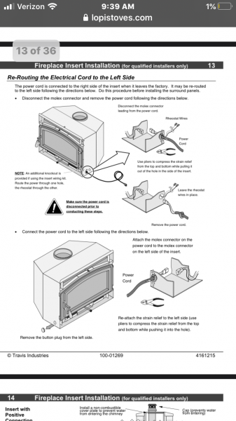

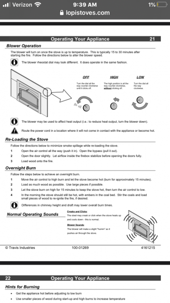

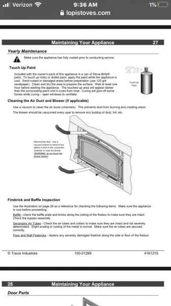

  19. FatBoy85
    FatBoy85
    Feb 25, 2017
    6,592
    25,100
    Washington State
    I don’t know if this is certain but the manual states that cleaning the blowers could be on the top or bottom. On the bottom left corner the cord for the outlet plug exits and the blower internal connectors are literally a snap. 1D0A5740-B67C-484D-91A5-97CB62A096F4.png 128066FC-251D-4263-96F3-8723874C6482.png CBCD8BA2-75A4-4F4C-B2FB-82E43D34ADD8.png
