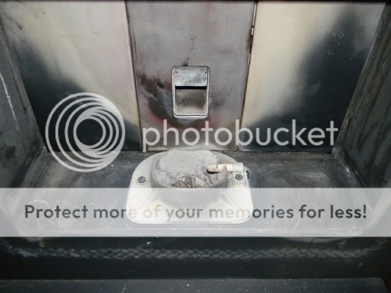

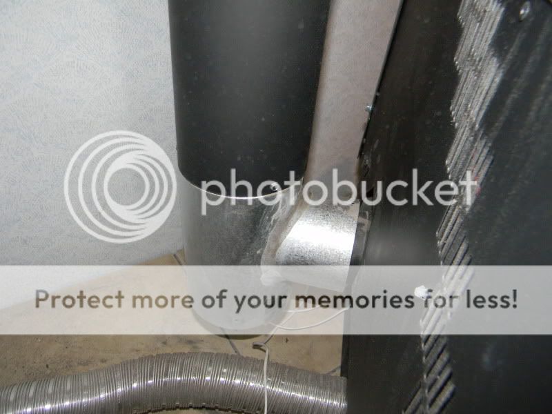

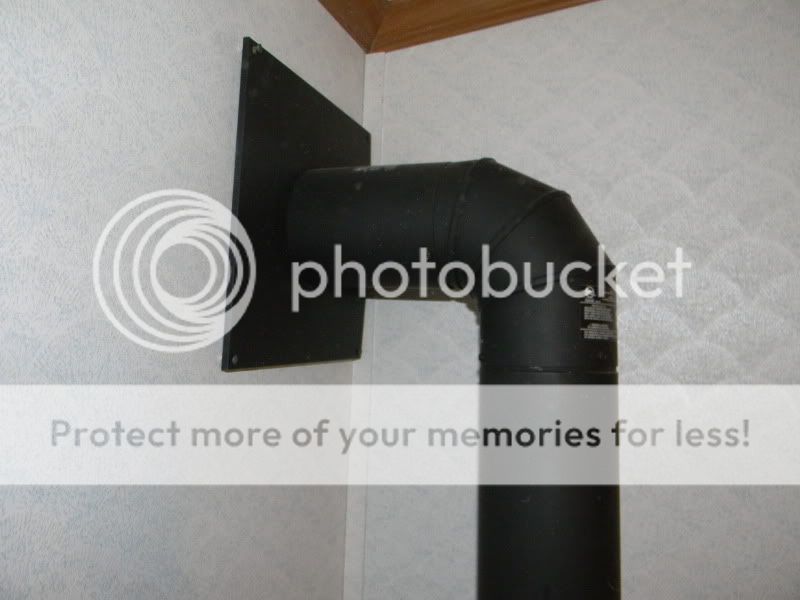

    This stove has always had an ash build up problem since the day it was new. From clean, spotless stove to almost unusable in less than a week no matter what pellet we try. I will post picture of the set up so you can see how the exhaust is run.

    During the height of the heating season if I don't clean the stove with that list above at least every 3 or 4 days, I will not run for a week. I have to clean the stove pipe out every 4 days. The ash will build up in the 3 foot long horizontal pipe about 1.5" deep.
    Once clean the flame is perfect on all settings but after only 2 days on high the flame will be lazy and almost touch the top of the fire box. I have to dump the pot at least once a day just to keep it running if it's on high. Dumping the pot and cleaning the holes does not change the flame when it burns. Only a full cleaning will bring it back to normal. It's like the stove doesn't move enough air to keep the ash from building up in the exhaust pipe and behind the baffles. If you want any other pictures, just ask.
    This is typical after about 2 days of burning on high.
    This is a clean happy stove. Those 3 baffle plates in the back get removed every time I clean the stove.

    Happy, perfectly clean stove burning on medium. Picture taken 2 minuets ago. Now it won't stay running. Runs for 10 minutes perfectly and just stops feeding pellets. I love this thing.

    Unless I am missing something (and maybe I am! :D), I don't like the connection to the stove......looks like there is soot weep there (at the top of the stove nipple)......
    Have we got any draft readings at all here? Clean stove vs. stove that's been running a couple days?
    I see a joint of flexi aluminum pipe on the floor....is it connected?

    No draft readings. No soot leek that I'm aware of. Cold air aluminum pipe is hooked up and clear. Tight house is most certainly not an issue, lol.

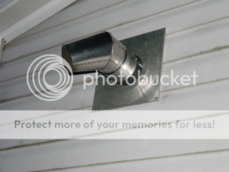

    okok, but WHERE does that intake pipe go, and how does it terminate? The picture shows it snaking away, but I cannot see where it goes, or how it ends......is it possible you're restricting the intake air with an end vent? If the intake doesn't go to the outside, remove the pipe....heck, remove the pipe anyways and see if it works differently......

    Pipe goes outside through the wall with the supplied termination. No restriction. It runs the same with or with out it connected. And I do appreciate every bit of input I can get about this. It makes me double check things I have already triple checked.
