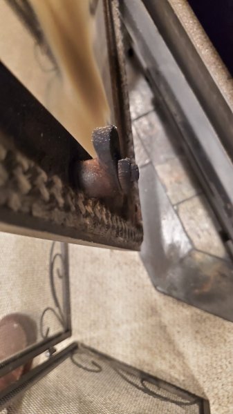

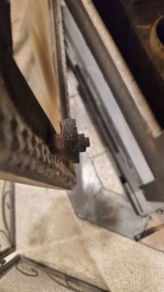

    Can you buy it from your dealer where you bought the stove at? Like to see a picture of the latch itself if possible and what are 'Magic Turds', never heard of that brand?
    The latch that is attached to the stove body on both of mine looks like a relaxed 'S'. All I did was wack it with a hammer to bend it in slightly so the doors latch tighter. Took the bolt out and wire welded them to the stove body as my bolt kept coming loose.

    I don't have a dealer, got the stove from the farm store.

    You probably won't like my solution but... You need to remove the door (they usually lift off the pins) and place it face down on a bench and remove the nut holding the latch piece and take an angle grinder and grind the boss down a bit and reinstall the latch and refit the door. Be a trial and error deal. Removing some of the boss will tighten the door up against the stove body. The gasket looks a bit flat but not overly compressed. ....And when replacing the gasket, same procedure applies. Door off and laid face down on a bench and take a wire wheel in a drill motor and remove ALL the old cement to clean metal and install a new gasket in the cement bead. The boss might come free with the latch after you remove the nut. In that case, put the boss in a vise and grind it down a bit. Again, trial and error until you get the tightness you want.
    It's almost impossible to replace a gasket and get the channel clean with the door on the stove.
    Really needs to come off the stove. Most of them just lift straight up off the pins. You might have to put a squirt of PBlaster on the pins first.

    One thing I see in your picture and that is, your unit is way too far out on your hearth pad. Carpeting is flammable. Your hearth pad needs to be out another foot at least. Taking big chance there.....

    Soak the latch with PBlaster first and let it sit 30 minutes.

    Grinding down the boss would actually make the door more loose, there's 3 washer behind the boss. If I could get the boss off and remove a washer or 2 the door would have a tighter fit.
    I've soaked the door multiple time in free all my personal favorite rust eater and I've also taken the torches to it with no luck of getting it off.
    The gasket is in decent shape, but is flattened a some. The original looked bigger but I never put calipers on it to check. The door does come right off and before I put the new gasket on the channel was completely clean.

    My unit is very close to the back of the pad and meets all requirements of the owners manual. It's been installed for 8 years without problems. I also never have any reason to open the door with it running.
