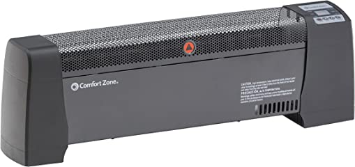

    In our situation involving an insert at the far end of a four level split we simply use a small electric heater in the far bedrooms, and one in the basement. They do a good job evening things out as needed in terms of house heating without the furnace kicking in as the thermostat (set at 68f) is fairly close to the stove. It is pretty easy to keep our main living area at 70f even during spells of well below zero weather with the wood stove. I have not noticed any appreciable increase in our electric bill since starting this practice.
    This is one we have have been using. They have a low and high setting, a thermostat, are lightweight, efficient silent, and have been reliable so far. I rarely have to put them on high, and on the low setting they keep our bedroom just right for sleeping even during the coldest winter nights.
