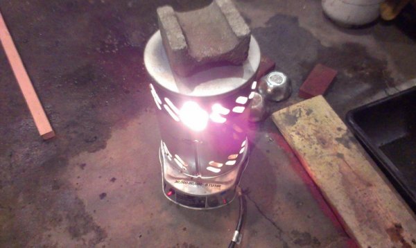

    I use this guy and it works decent but man does it get expensive! I like the pellet stove idea a lot MM plus you only need a small amount of pipe outside.
