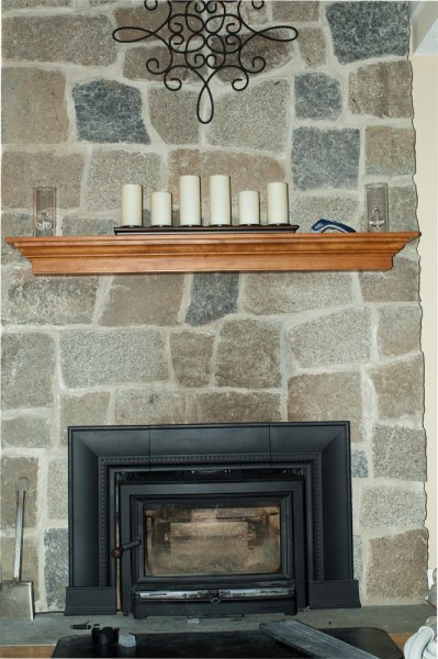

    Due to our excessive draft we are replacing our Clydesdale with one of these stoves. Firebox sizes are very close to one another 2.3 for Heritage, 2.5 for Oslo and 2.4 for Clydesdale. Not sure if the soapstone will heat better/longer than cast. Clyde does a decent job of heating our 2000 sq/ft. and glass stays pretty clean. PH will fit but I would need to extend hearth and raise mantel. Wife does not want me to do it if I do not have to. So we will give one of these a go first as both will fit with no modifications. Looking for a recommendation. I am really torn about which stove to get. Dealer will work with me on the Heritage (due to clyde problems). By the numbers Oslo wins looking at EPA chart Heritage wins. My head honestly hurts trying to figure out which stove to buy.
    Any help would be appreciated!

    I need rear vent so the Mansfield is out. Jotul is old school cast. I would load around 5-5:30 in the AM and again around 4:30 PM with the night load around 10 PM and repeat. Both me and the wife work so no one is around to feed it during the day. I only know of three stoves that will fit. Jotul, Hearthstone and Woodstock.
    We use the stove to heat the main floor mostly and to enjoy the higher temps but the furnace usually comes on during the night when we get into this type of weather. Shoulder season we would be 24/7. Looking to cut back on the amount of dino fuel we use. Wife is worried about the pipes freezing if we heat exclusively with the stove in the new normal winters we have been having these past couple of years.

    Thanks for the info. Unfortunately the PH is out. Did a mock size and it is just too big where it would be. Worked out a trade with the dealer on the heritage but am waiting for him to get back to me. Tried to contact him a few times and have not heard back from him. It is looking more like the Oslo.
    Anyone know of other stoves that rear vent and can fit under a 27" lintel?
