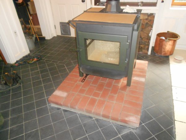

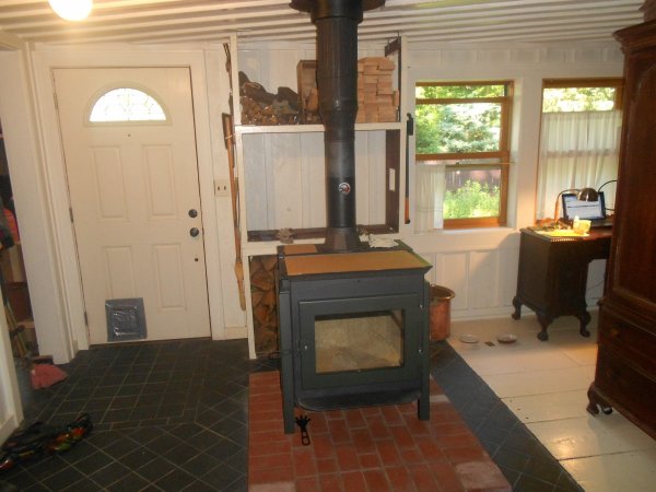

    cripes. that was the easiest and most intuitive,, let alone successful pic i have put on a forum. okay. this is chucker's foyer, aforementioned brick hearth pad- the wife and i worked out the pattern- IS stove which i figure will be handy to burn wood in, in tasteful and easy on the eyes charcoal/moss green, floor to ceiling wood rack adjacent to front door. this is as good a life is going to get at least for folks like us.
    i have hopes for this hearth pad. small effects and nitpicking are the soul of good work in the trades. between the heavy stove and the hearth pad this is about all you would wish to plop on 4 2x10 floor joists otherwise the hearth pad could have been taller. were it more massive it would retain more heat, however, i figure things are on a 24 hour cycle and you need something compact enough to just come to heat during one long burn. hopefully you do the burn, maybe 14 hours, the stove and pad hold up some amount of time beyond that, and the mass of the building adds time until the stove needs to be rekindled. this is conjecture at this point. i am thinking that in transition weather the stove might need to be lit once a day. with an efficient stove and an efficient building hopefully you can expand the amount of transition weather and shorten the all day burn weather.

    Love the simple configuration of your IS. When I first saw the customization options of the IS, I thought to myself "who wants that?". Well, clearly I was wrong as it appears 99% love the customization. I guess I am in the 1% that like the "stock" configuration which I assume is what you have.
    With no andirons, is your plan is to load N/S? Do you have any of the soapstone panels on the sides?
    You know, one picture really isn't enough for most of us here. :)

    the simple look is good for me. the really important part of that is the stove top and not having the gear or other appliques on the front. i plan to do a lot of cooking on the stove as well as heating hot water bed warmers &c. and the smooth top is flexible for any shape you put on.

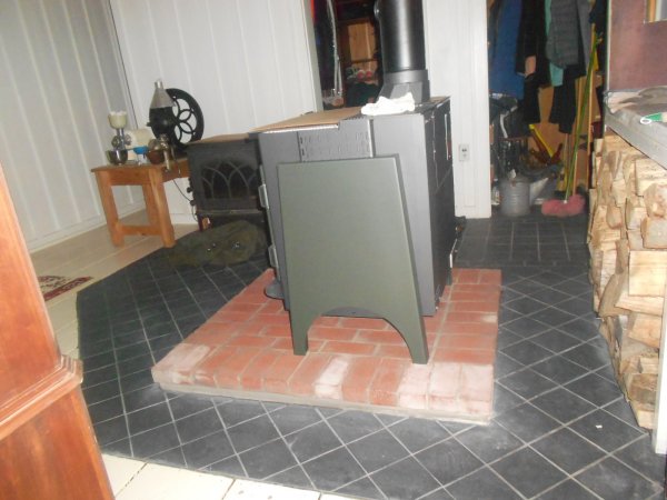

    i was thinking N/S loading would be easiest. is this so? i didn't order soapstone panels. what do they weigh, and are they advisable, they can be done later. will load some more pix later.

    I would think you could add the side soapstone later. As you can order Xtra ones my guess they weigh about 100 pounds and would give you more radiant heat than the hearth wood. I mean that's why people make soapstone woodstoves. I assume you got the soapstone inside. I really think I am gonna so like that better than firebrick..
