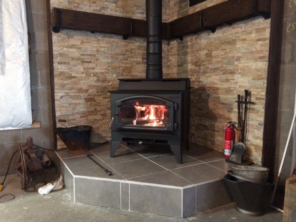

    I’ve personally done two and helped with others. Here’s my basement hearth:
    Back stone was honey ledger from Home Depot. This stone was thinner than my other hearth and easier to deal with (more on that later).
    Tile was from HD or Lowe’s.
    Plan on renting or borrowing a tile saw if you don’t have one- it cuts stacked stone, too.

    Thanks for the advice and especially the pictures! Buckthorn, your stacked stone is what we're looking at almost to a tee, very helpful to see it in action. Thanks!
