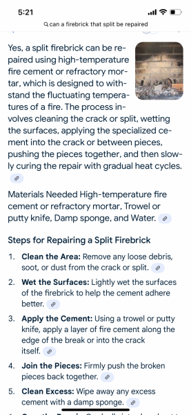

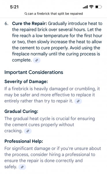

    Hello
    I see it can be done but has anyone done this?
    Is any refractory cement or refractory mortar adaquate?
    See info below
