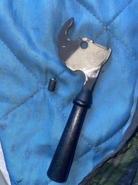

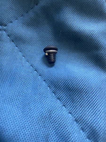

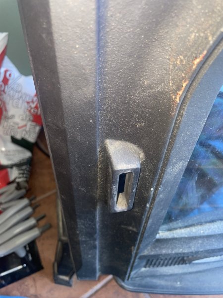

    The bolts on the inside of the fire door that hold the door handle latch got very loose and with just a pull on the handle it fell right off!
    Adding 2 c-lock washers under the bolts should keep them from getting loose again.
    Has anyone else seen this?
    Pic 1 - Fire Door handle on front of door

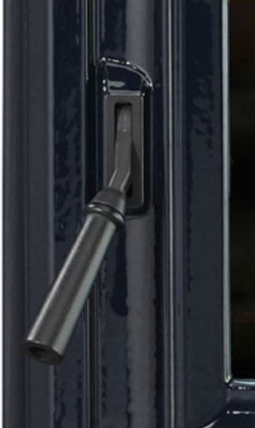

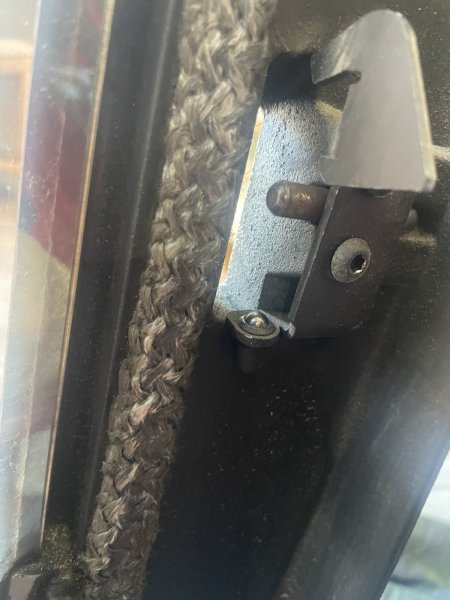

    Pic 2&3 Inside latch

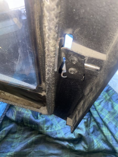

    Pic 4 - Handle and ball latch

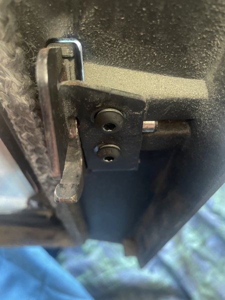

    Pic 5 - Outside fire door no handle
    Pic 6 - Bolt with new added lock washer
    Pic 7 - Inside latch with 2 new washers under bolts
