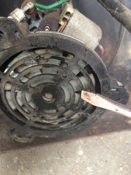

    6. The exhaust blower started with a kick from the screw driver but then died!!!! LOL

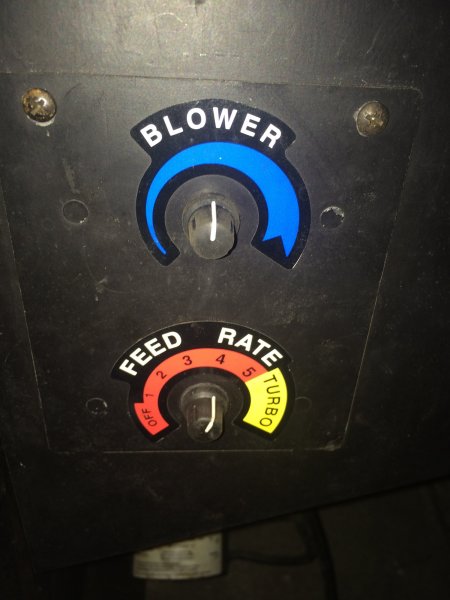

    Pic 1 - Control Panel

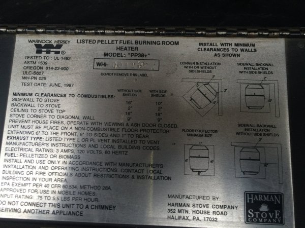

    Pic 2 - Full tag
    Pic 3 - Model & Serial

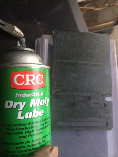

    Pic 8 - Back of slide plate is dirty
    Pic 9 - Cleaning pitch off that made it stick tight!
    Pic 10 - Lube slide platw with "Dry Moly"

    Pic 15 - Original exhaust blower needs kick start with screw driver!
