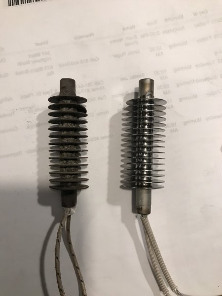

    Here is something else.

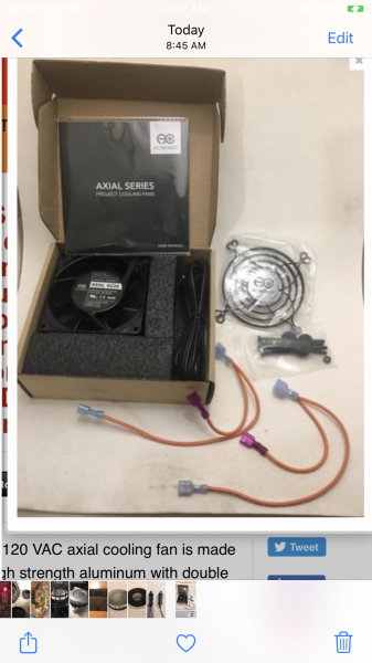

    There are still some 13 fin Harma igniters around! After sitting all summer it did not get hot enough to light the pellets. Every other part was changed except the exhaust blower! This blower has the extra cooling fan with the black plastic guard on the back and still works great! Remember heat is the # 1 cause of bearing failure so having an extra cooling fan like computers to keep the parts cooling will extend their lives!!!
    I changed an old 13 fin igniter in a P68 Thursday so here is a pic of the old and new. :)
    I make up jumpers to connect the cooling fan to the exhaust blower so it goes when the exhaust fan goes and mount it to the inside back panel
