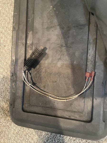

    1. The igniter is weak
    2. The igniter Triac on the circuit board is weak.

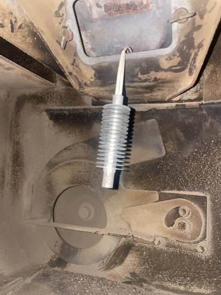

    In this case the igniter was approximately 6.5 years old and the stove did have heavy winter use from beginning of Oct to end of May approximately 5-7 tons in Stove Mode or continuous burn.
    Therefore the igniter was replaced and stove started

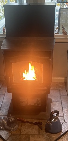

    It took exactly 7 mins and no big fire
    Then it went to run mode and the fire settled down and ran perfectly
    Pic 1 - Out with the old igniter
    Pic 2 - In with the new igniter
    Pic 3 - It works!!
