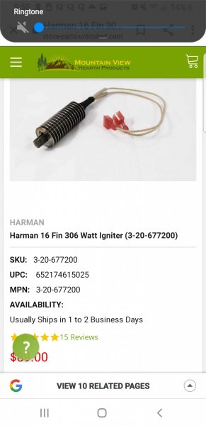

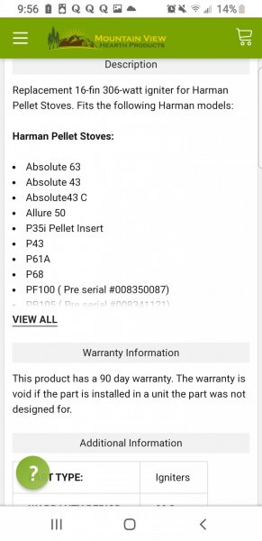

    Didn't know they made a 16 fin model.
    imacman and ivanhoe like this.
  8. badbob
    badbob
    Apr 23, 2014
    2,482
    9,946
    LOL! Yes, things change.The "number of fins" thing has been going on for quite a while. I have seen it go up and down. If you want the "best", perhaps purchase the Harman item, but, all of them are made in china, the quality of the items from china has vastly improved, over the years. the igniter I put in my BIL's stove is aftermarket, but bought from Mountainview. If you have any doubts, call Mountainview, and ask for their opinion, and number of parts sold. They are super honest and very knowledgeable.

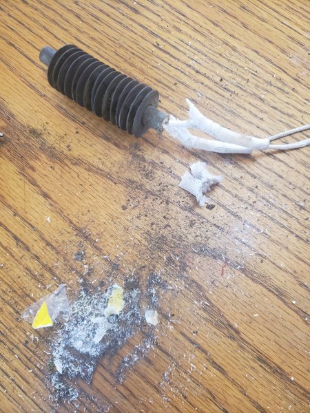

    my money is on the fire resistant insulation on the igniter wire fraying and grounding out inside the burnpot. And if the burnpot was recently replaced, possibly a pinched wire is also pretty common.....but.....I stick by the frayed wire issue

    Funny you should mention frayed wire. I haven't opened up and looked at my ignitor yet as I'll wait till my new one comes tomorrow and replace it. But a couple years ago I have The Frayed wire in the igniter box probably from the hundreds of times I figured out the ash and probably rubbed against it not realizing it. Anyways I was cleaning out the igniter box must have pushed the wire up against the bare metal got a shock and the stove fuse blew.
    Duh. Good example of what you just posted about from Ground Zero. LOL
