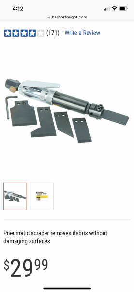

    Hello
    One of the best tools I have found for cleaning the old Harman black carbon speed bump is the Harbor Freight - Air Scraper Kit
    Only $29.99 you cannot go wrong!
    Works amazingly well!
