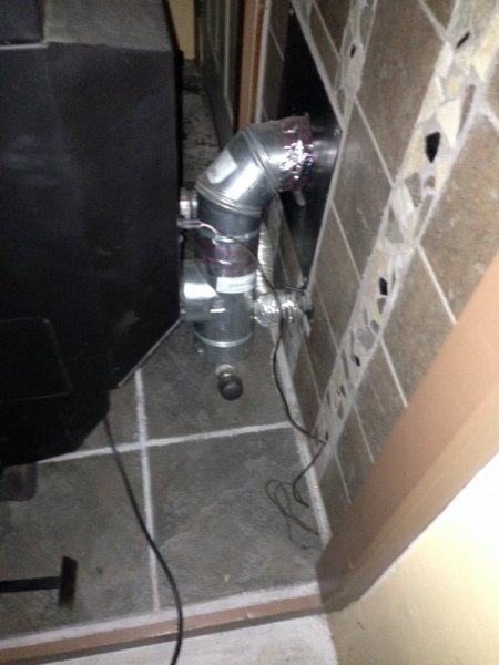

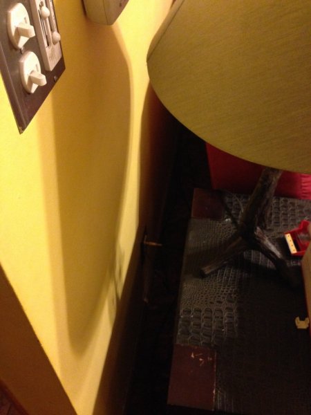

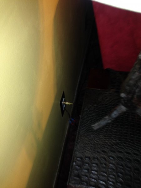

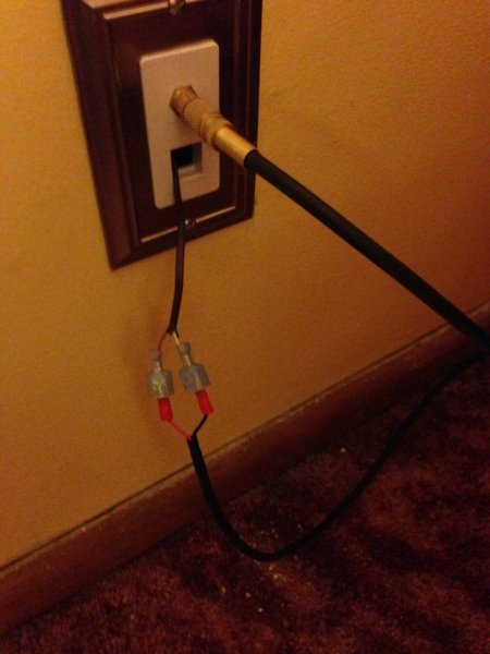

    Using stove temperatuure now but want it more automatic, so I extended the room probe upstairs. The old sub woofer outlet had an extra slot so it seemed to work out well.
    Just laying it on the floor behind the couch does not seem to be the best configuration.
    The Harman DVD states the room probe should be 5 - 6 feet off the floor.
    We upgraded from the old gray room probe to the new black room probe.
    Any suggestions? What mode do you use?
    See pics

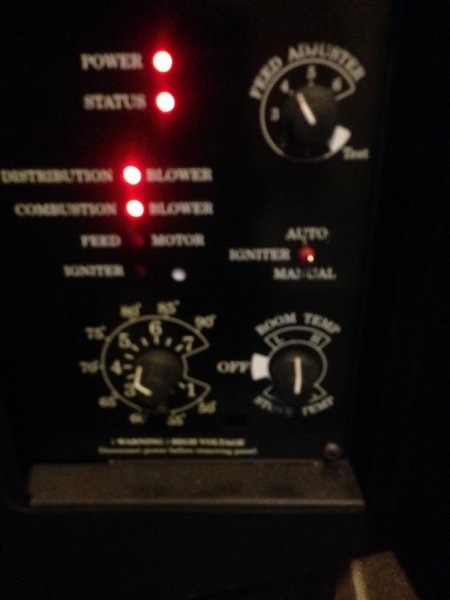

    Another try here with better results.
    Moving the room probe up to the recommended height by looping it around the old oil T-Stat is much better and now serving a more useful purpose! LOL
    This room probe is approx. 8 feet from the livingroom register and 7 feet from the Kitchen register where the Harman pumps the heat out! With approx 176.7 Deg F of heat blasting out the 2 registers this is good ole automatic Harman Heating! See pic!
    Not too close and not too far!
    After setting the Harman Temp dial to approx 73 an hour later the old oil T-Stat read 73 Deg F ! ! !
    Have to try a few more settings but looking good now! :)
    Ok, setting up Harmy1 to 70.o Deg F on the temp dial was too low and 72.5 was a tad to high because it is 74 Deg F in the Livingroom now being 21.0 Deg F outside.
    I just turned Harmy1 down a tad in between 70 and 72.5 so I am hoping the sweet spot is 71.25 Deg F on the Temp Dial with the outside temp 20.8 Deg F now and maybe it will regulate when the temp outside drops further. We will see!
    See pics
    Click pic to enlarge!

    Update:
    The room probe upstairs worked well last night keeping the living room a much more constant temperature as the fire ramped up and down.
    Not a pellet stove furnace but maybe the next best choice for a smaller home.
    The temp dial setting of 72.5 Deg gave the livingroom a constant 73 Deg temp on the old oil T-Stat
    That was a tad too hot so I turned the dial down to 71.25 again and got 71 to 72 Degs F in the livingroom as the basement temp near the stove is 78 Deg F
    For this smaller house, it works well and nice to have a stove in the basement to enjoy.
    I do recomment this setup with registers so the stove can sense the temp and adjust properly so it will not be ramped up and blasting away all the time.
