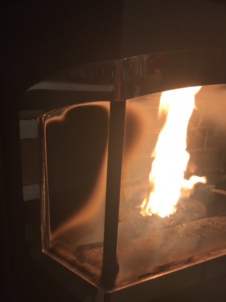

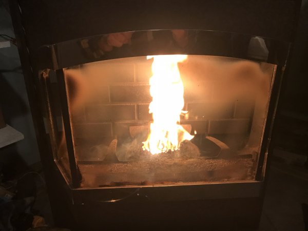

    Anyone have an idea why the Advance seems to cloud up the glass on the left side.
    Myself and my buddy has the same stove and it always smokes up the the left side of the stove.
    Just wondering
    Thx Cliff

    possibly clogged air wash by glass.....do you use the logset? It makes it worse. Other than that, the Advance is hands down the unit with seems to have dirty glass quickly. Also, shoulder season....when the units run at a low rate, the glass gets dirtier.

    How about a good pic here?
