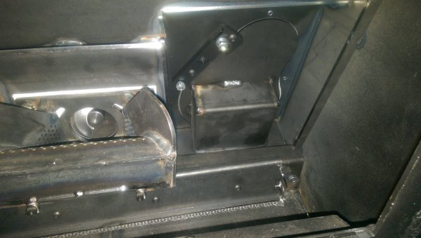

    this is the location of the combustion blower cover....to the lower right of the burnpot. In this pic, the exchanger cover, flame guide, and medallion have been removed to better show the location. The latch is closed in this pic

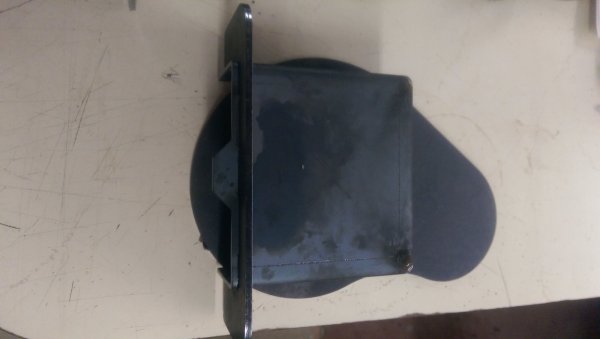

    this picture is the combustion blower cover removed. Please note that this is an OLD, original combustion blower cover. It has been replaced with the NEW one below. The Harman part number of the new one is 1-10-574087A. The new one is pictured below.

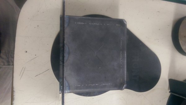

    IMAG0243.jpg This is the NEW combi blower cover. Note the tooth on the underside.....this holds the cover in place. its recommended that if you have an old version cover, you should get a new one from your dealer. Its covered under warranty, so shouldn't cost you anything. Be sure to latch the new cover on when putting it in place.

    Thank you for sharing that, I think we have an old one. We went back and removed the covers and plates and reset everything. Stove has been burning for 3 hours so far without whistling. I also printed out the most recent owners manual. Thanks again. I'm sure I'll get the hang of it in time.

    Is that a new burn pot ?? Mine doesn't have the holes on the side , maybe it's for the insert only ??

    Will, yes, AFAIK, its 52i only.....never saw a ventilated Accentra F/S burnpot at all....not saying they don't exist, but I've never seen one.....
    The holes in the side, I THINK, was an attempt to minimize carbon accumulation at the auger, but in reality, it seems to minimize air by the igniter enough to slow the ignition...if a stove gets even marginally dirty, well, then there's no ignition.

    yea, JG, I think you will.......I would suggest getting with your dealer and having the burnpot and combustion blower cover replaced.
