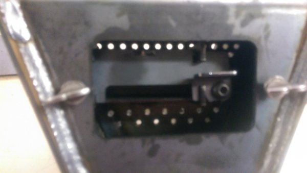

    here is a picture of the new igniter bracket inside the newer burnpot. The little lever on the right lifts up, the cover comes off, the igniter sits inside,and the cover goes back on, held on place by the latch....note there isn't an igniterin this picture!

    New hole pattern all around the igniter. Interesting to see how that works out.
    How does the pattern of holes almost all the way to the lip work? Does it help in any way?

    the igniter actually is the 5 holes you see....been like that awhile. The lowest holes are different, but I think that's a carbon deterrent feature...
