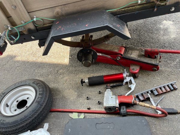

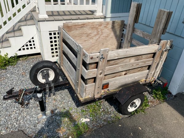

    I have a nice HF Trailer Frame I picked up used and build it up with wood on the sides. When I first got it, I took it on the highway and one of the bearings froze and burned up the tire. That is when I realized Triple A did not cover the $500 towing to my mechanic on it. I had both wheel bearings replaced & greased and the tire fixed. That was 2-3 years ago. The last time I used it just the other day, I heard a Tick Tick noise in the left wheel. So I jacked it up and added grease into the nice new zerk fittings on both wheels for the wheel bearings.
    Now the Tick Tick noise is gone but there is still a slight rubbing noise in the same left wheel. The other wheel is perfectly quiet when I spin it. Both wheels seemed to take the grease fine and I wiped off the grease and dirt on the inside of both wheels.
    Is that rubbing noise in just the left wheel ok or does this need further attention?

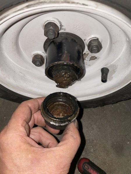

    I'm saying there actually was some water got in there...that grease doesn't look too good at all, especially for only being a couple years old...was that high temp wheel bearing grease used in there?

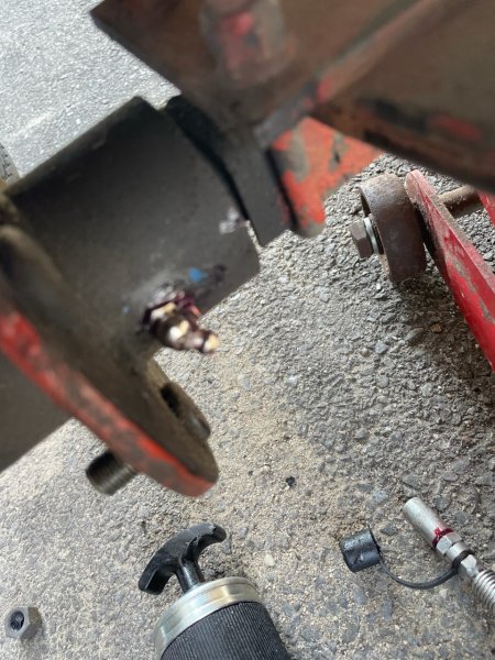

    Also, when you grease it using the zerk that was added, do you pop the outer cap off? Probably not as likely with those steel caps, but on hubs that were sealed on both sides, I've seen the seals get popped out using a grease gun to lube...pressure has to go somewhere.

    Thanks for all your info and suggestions. The zerk on the back may only get to the back bearing so I did pop the cap to check the grease in the front. I always use the red high temperature grease on pellet stove auger bearings. This grease and the new bearings were put in by the auto mechanic. So not sure what kind of grease?
    Just curious why you say this grease does not look good? I do not have any experience to tell?

    142,241
    By the looks of it that zerk should be in between the two bearings, so I would think it would push grease to both sides as long as there is somewhere for it to go.
    Well, it would help to know what color the grease was to begin with, but even if it was a brown colored grease when new, it looks dirty and kinda like thin mud...in my experience (and I've had hundreds of "swamped" bearings apart) when the grease looks like that right there, it had/has water in it.

    I thought about the location of the zerk and it cannot be in front of the hub because then the wheel would not go on.

    Don't you have a parts washer? (thought I remembered seeing that a while back)
    If so I'd wash it all out completely and evaluate the clean/dry bearings and races before repacking them...you can tell a lot about a bearing once they are all cleaned up good. If no parts washer, you can wash them up in a pan of kerosene or diesel fuel using an old paint brush...wear gloves or you will smell like fuel all day.
