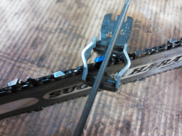

    I had a harbor frieght never used it sold it on ebay NCM_0127.JPG I like to hand file.I really like these made by husky/jonsered gotem at tractor supply.I need to start learning how to squarefile thanks to the awesome info thats on our site.
