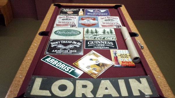

    It's exactly what the title suggests? I have a bunch of signs that I want to hang on my basement/block wall? What's the best way.
    I could drill into the mortar lines and use small nails? I thought that may be best. The wife suggested Liquid nails :confused:. I told her that was a great idea, but... No.
    I have more signs coming. . And a bunch of Nascar License plates that I want to hang.
    Thanks for any help in advance. :)

    Looks like all of the stuff you want to hang is light.. So adhesives or double sided tape should work. If you wanted to hang something heavier, i'd drill into the block with a masonry bit, pound a wooden dowel into the hole, saw it off flush with the wall and then pound a nail into the middle of the dowel. Would require some accurate measurement beforehand to ensure that you're drilling in the right place. Additionally, if you drill through the block wall, you'd need some construction adhesive to keep the dowel from pushing through.

    If I drilled, it was gonna be 1/16" holes, about an 1/8"-3/16" deep and only into the mortar lines. I have some super small nails I just just gonna stick in them.
    Think I will try the 3M sticky tabs 1st. These signs are pretty thin and light.
    The 2 posters are going under the glass top of the bar. :) But the tacky stuff still might work for the smaller signs.
