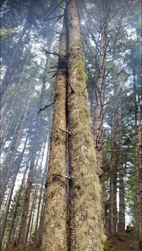

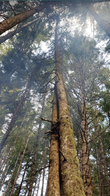

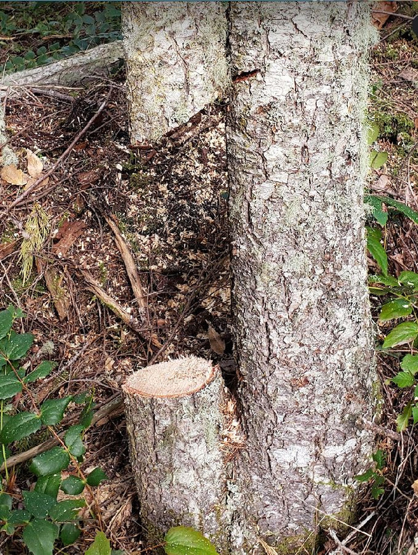

    Here's a tight pair of pecker poles.
    They're so tied up the first one I cut didn't even settle when I cut the stump out from under it.
    It's just hanging there in mid air - it never hardly moved.

    Well if that doesn't make you pucker a little....

    Siamese twins? Thats cool. I love "freak of nature" tree stuff. Thanks for sharing.

    Codominant stems are looked upon poorly for a reason, post more pics of the outcome!

    I'd call them pucker poles. I hate those take downs, way to many variables, and most are bad.

    Face the remaining one to the lean of the cut off one. Put the backcut in carefully . The hanger will probably pull the standing tree into leade.
    I've had to do that many times pre commercial tree thinning with trees that size . And with old growth Sitka spruce and western hemlocks.

    If you could get something between them and using a come-along, at a distance, giving the cut one a good tug might pop it free. Emphasis on distance.
