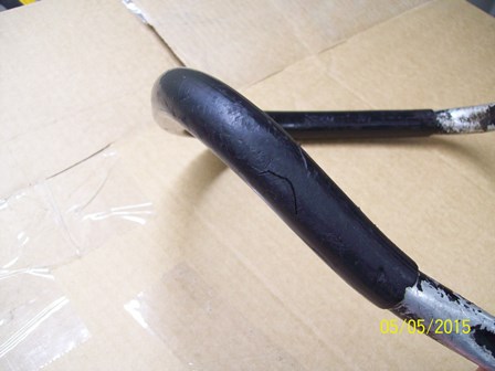

    I read some comments about using heat shrink tube for handle bar wrap (hose) and here are the results I had on an old Jonsered 630 handle.

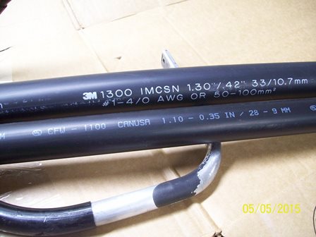

    I picked up two different shrink tubes at the electrical wholesale house and tried a small section of both to see which one worked the best.
    Beat up old handle:
    New tubing:

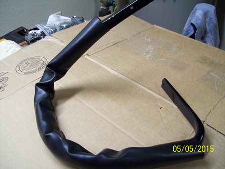

    I ended up using the "Canusa" 1.1" heavy wall tube. The printing will come right off with a little carb cleaner on a rag. This stuff doesn't like to go around corners so you have to work it on:

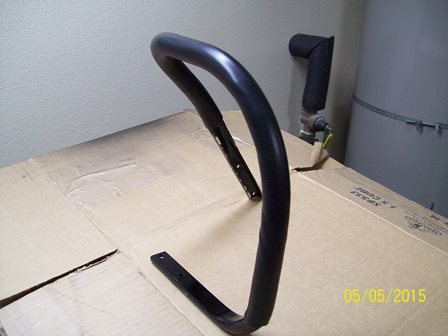

    Start heating at the center, and work your way to the ends. You have to stretch it a bit to keep it from getting rippled. Once it is shrunk, trim the ends and it looks like this:
    The stuff gets thicker as it shrinks so it makes a nice handle cover that is hard to tell from the original. Not bad for the first one, and I'm sure there are some tricks to learn.

    Forgot to mention- cost - it was $37 (wholesale) for a 48" long piece of tube, which is enough to do 2 bars. The 3M version is only $21 but it has a thick coating of glue on the inside, a thinner wall, and just didn't seem to shrink as well.

    Did you use the tubing with the adhesive inside?
    Bert, Horkn and Eric VW like this.
  8. Eric VW
    24,152
    138,447
    I agree that the adhesive lined tube is unsat.

    Will try silicone spray next time, and I'm sure that will help it slide on. Once the tubing is heated and shrunk it seems to feel a little more rubbery and is gives a pretty good grip.
