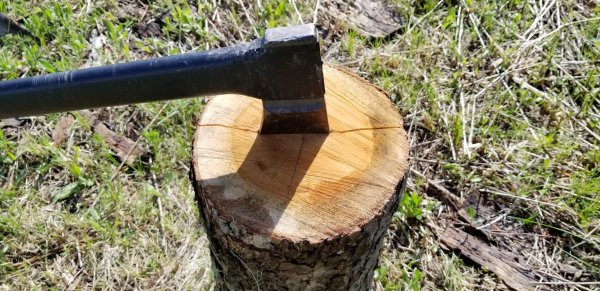

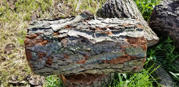

    This one is ready for splitting. Note the branch knot on the side. No problem:
    Notice the checking and light end grain color:
    1st stroke
    2nd stroke

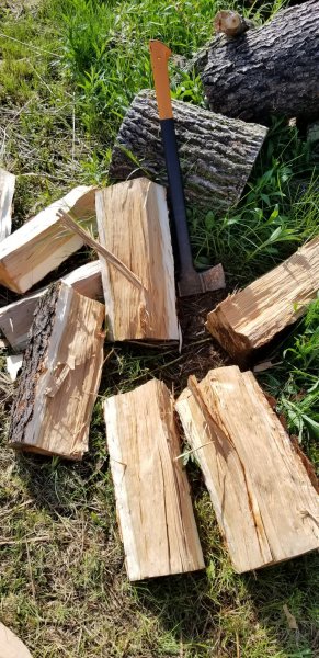

    And 2 strokes later ready for the stacks

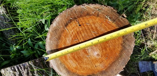

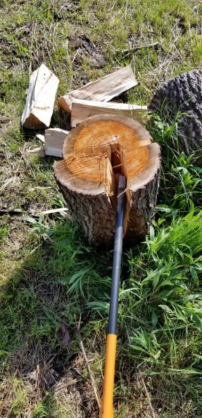

    This one was not so ready. Notice the end grain color:
    2nd stroke
    4th and 5th stroke
    Nearly there now
    And ready for the stacks
    As I'm sure you can tell the larger round being a bit greener required a bit more effort but nothing herculean. Both rounds have been bucked about 8 weeks and laying out in the field waiting to be split.

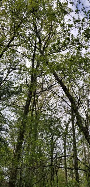

    Maybe some future cherry for the stacks. Gotta "move" it out of someone's back yard first. 20190520_103905.jpg
    Something tells me this section here isn't sound:binoculars: 20190520_104006.jpg

    That will pose a problem when felling for sure Barcroftb ?

    Not a problem at all. I'll just put on my magic fairy wings and lay it down gentle as you please. :rofl: :lol:
    All kidding aside great care will have to be exercised and it will cost the homeowner dearly. It's not your average "you cut down the tree and keep the wood for freeeeeeee" score.

    That's an ugly azz tree there Barcroftb . Good news is it shouldn't be too hard to judge the lean/balance.:rofl: :lol: That thing looks like it's just waiting to slap ya right in the face.
