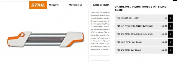

    I love my Stihl 2 in 1, IMO it is the best all around. It's fast, its easy, does the rakers, and it sharpens extremely well. Only con is it's a bit pricey but worth it to me.

    Can you use multiple file sizes and is it easy to keep the correct angle while filing?

    Yes and Yes. That orange area pops open to swap out files. The way you align it on the chain allows for almost perfect angle every time. You can't really hold it any other way but the correct angle. I just learned/noticed the other day after having for a few years there are marks on the file showing the correct angle along with the edge of the tool showing the correct angle. If you have time check out some reviews on youtube it's really a great tool.

    Can you use for different pitch chains or is it pitch specific?

    Pitch specific

    I have 3 different pitches of the 2-1 along with individual files. The 2-1 does a good job, especially for a quick touch up when refueling. The 2-1 doesn't take the depth gauges down as much as I like so I use a flat file and a progressive plate when I feel the saw not pulling as hard as I want. I will use a round file after the 2-1 sometimes too. I can feel the round file grabbing for a pass or two even after the 2-1 sharpened a chain. Maybe I need new files for the 2-1 but I can see it pulling metal still.
