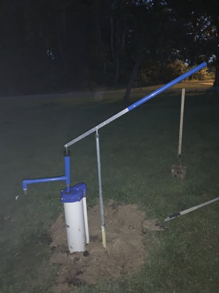

    Today’s big project. Installed a hand pump for our deep well. If electricity goes out, so does our electric well pump. If it is prolonged, like with an ice storm, or worse, we have no other access to running or standing water. This pump reaches the depth of the static water level, 45 feet below ground level, plus about 15 feet extra for a total of 60 feet, to take into account fluctuations in well water level with seasons, drought etc.
    I still need to install the hand lever which pivots on a 4 foot piece of galvanized pipe, cemented into the ground next to the hand pump.
    I’ve been researching deep well hand pumps that can be installed alongside an electric deep well pump for a year. I decided on one from https://www.apocalypsewellpumps.com because their design is bulletproof and idiot proof and doesn’t rely on yearly replacement of rubber or leather seals inside the pump mechanism.
    Yes, I’d recommend them. Compared to alternatives they are reasonably priced and appear very well made with a unique pump design that won’t wear out. CC00B61C-4ABF-48BE-8584-8FAF0EC718A2.jpeg

    Kinda reminds me of a modified bike pump. How will that hold up in winter. No chance of freeze issue?

    Is that well casing pvc or painted white? Never seen pvc used for well casing if it is.

    The well is 300 feet deep with a 6” steel well casing that came up and ended below ground level in a 2 foot deep pit. We had it brought up to code and they used pvc for the last 4 feet, with a pitiless adapter 2 feet underground.

    I got the hand lever installed this evening. It makes a huge difference in ease of pumping: AA41F103-17CF-4F23-B4FC-00C076D51A11.jpeg

    Do you have any out of the ground pictures ? I'd really like to see the design of it mainly the actual pump.

    The guy has a great video on how the pump functions. It’s pretty unique among deep well hand pumps. Watch the mechanism starting at 2:10 into this video:
    I have no interest in him or his company. I just liked his design concept as it was completely different from other hand pump designs.

    The long hand lever gives three to one mechanical advantage lifting the water, and you’re pushing down on the lever arm instead of lifting the water column up as with the handle in my first photo above.
    This pump requires lifting just less than one pound per foot of depth. I’m pumping from 60 feet down, so I’m lifting almost 60 pounds with each upstroke with the old handle.
    With the long hand lever it requires pushing down instead of lifting up, and with the 3 to 1 mechanical advantage of the lever arm, you’re only pushing down 20 pounds. And you can use your body weight to do that.
    I looked at the Bison hand pumps ( Well Hand Pump For your 300 Feet Deep water well ) as well as the Simple Pump (Simple Pump | Quality Water Pumps and Well Pumps ) and the
    Oasis pumps (Pumps )
    I decided on this make and model and I think it was the best pump at an economical price.
