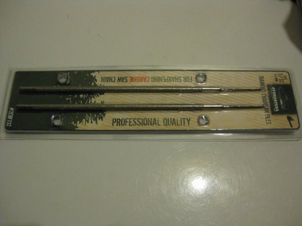

    Went to sharpen a 25" chain earlier this week and the file just skated off some of the teeth whereas some of them it sharpened as usual. Tried a new file and same result. Used chain that ive previously sharpened by hand. Did the last cut overheat and harden the leading edge of the teeth? Ive had this happen before with fresh out of box chains, but dont recall this ever on used chain. Anyone else have this happen?

    My guess is the diamond won't give you the results you desire. Do you have a dremel or do you have someone that can put those hardened cutters on a grinder? Just takes a little to grind off that super hard metal.

    Is it .375 pitch chain? Id be glad to send you the extra 7/32 file Bill.
    I did sharpen with the diamond file this morning, but didnt go back with the "normal" file to see if it got rid of the hardened metal completely.

    Hello buZZsaw I just got around to checking your post most diamond sharpening files and wheels work better with a little lube on them wd40, diesel fuel light oil I have the wheels to sharpen the fire co bullett chains they were @ 300.00 each . I also have noticed that some brands of files work better on certain hard chains Pferd files seem to be a little harder and deal with that problem better JB

    Didnt seem to clog the file up that i could tell. Normally i tap the file on the vise to knock off any filings.
