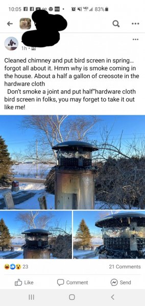

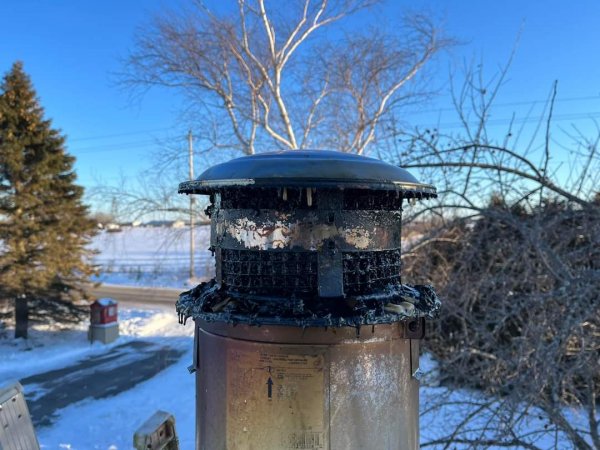

    This right here is NO BUENO!! Moisture issues in the wood and/or low-idle fires.....
    Saw this on FB today and thought I'd pass it along....

    This easily happens with dry wood and superb burning practices as well. It just takes longer. The problem is the screen. If you are not required by some odd local rule or rodent issues to have one then you might consider removing it. I did.

    In this particular instance, I totally agree. For buildup that badly in a half season, they're burning wet wood......

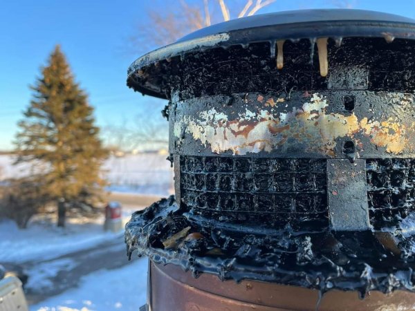

    I agree.Looks as if plenty of tar filled pine was burned in that stove.The screen for me is too narrow.My screen is 3/4 " mesh.Narrow enough to keep the birds out and wide enough not to clog too fast.

    So...the pic in original post....how do you clean that? Take it down and burn it off in the yard? Spray with some kind of miraculous cleaner?

    It will depend on how gooey it is. Mine plugged with dry stuff that could be brushed off easily from inside and out with a regular wire brush like for welding. Think dark brown cornflakes.

    That looks right nasty....

    46,980
    295,947
    I've cleaned several screens that were almost plugged simply by tapping the screen and doing it from the ground. That got the folks through until summer when they could take it down to clean it totally. What I used was the poles we use for cleaning chimney. You do have to be careful and only tap lightly else you will destroy it.
