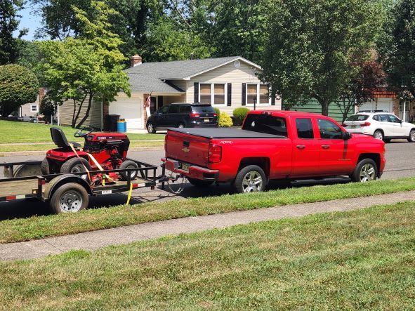

    Newest addition to the wood hauling crew "Little Red"
    Big and Little Red

    Nice find! That should have the onan engine in it I hear theyre powerful but thirsty.
    Screwloose, ReelFaster and Chvymn99 like this.
  18. Chvymn99
    20,946
    110,295
    Congrats! Fine looking machine...
  19. Dok440
    Dok440
    Mar 7, 2021
    1,320
    9,287
    NorCal
    I've never seen a Toro like that, looks stout!

  20. Stephiedoll
    Stephiedoll
    3,893
    27,914
    Omaha, NE.
    Pretty big for a little red. Nice find.:yes:
