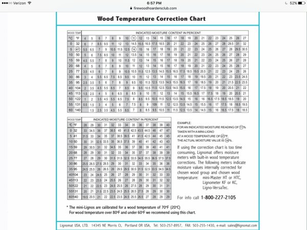

    Not sure what you mean when you state wet wood. Wood that has been rained on? Wood that has never been top covered after stacking? Wood that animals have peed on?
    As for your elm, indeed when you find standing elm with no bark, 99% of the time this is prime firewood. However in our experience most of the time the bottom 1/3 of that tree needs another year of drying after being split and stacked. Also in almost all places it will also pay to top cover the wood while it is drying.
    Also it makes a difference how you use that MM. There are right ways and wrong ways.
    For some reading and hopefully learning, take a look here: (3) Primer on Woodburning by Backwoods Savage | Firewood Hoarders Club
