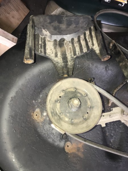

    Most mower decks have sealed bearing that last about 15 years. This LT 1000 deck is 17 years old and when I spin the blades there is some noise and some resistance. So it seems that the only way to keep it going for a few more years is to paint the top and dry moly above the blades.
    So I cleaned and painted the deck here and watched the vids on greasing.

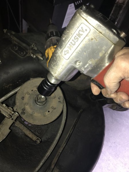

    pic 1 - remove pulley with impact air wrench
    It was stuck, impact really helped

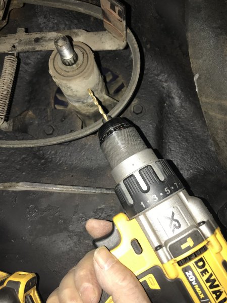

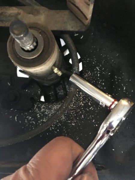

    pic 2 - Drilled hole for 1/4” x 24 thread Zerk
    Used 13/64 to make it tight - 1/4” should work too.

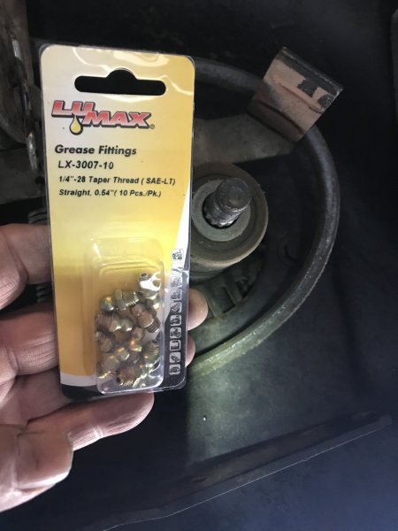

    pic 3 - Lu Max Grease fittings seam higher quality so they may last. Cost about $10 for 10

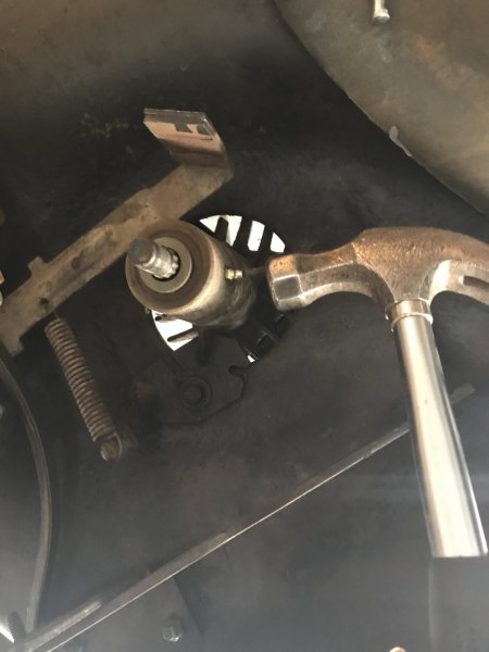

    Pic 4 - tap zerk with hammer to get started
    pic 5 - used a 5/16” deep socket

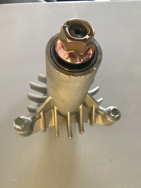

  3. don2222
    don2222
    Nov 10, 2013
    3,393
    4,748
    Salem NH
    Thanks for the info

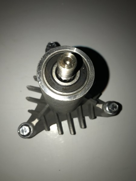

    Some vids say when you pump in the grease, it pops the seal so I will try this first, such as this vid.

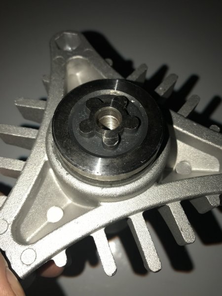

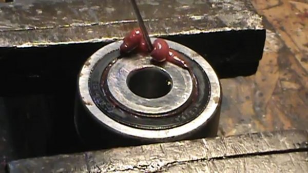

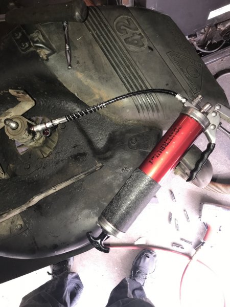

    pic 1 - grease gun needle to get by the seal.

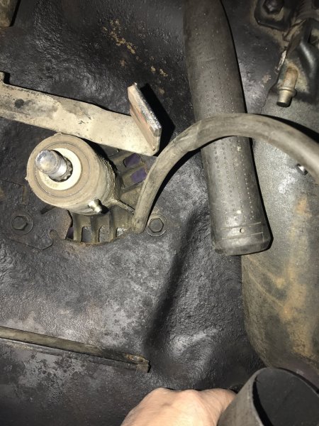

    pic 2 - Example of greasing bearing with needle adapter. The black ring is the bearing seal and can be pryed out with an awl or exacto utility knife.

    I got new spindles also if this does not work. I do not want to stick the needle into the top seal in the top bearing, and cannot even get to the bottom seal on the bottom bearing.
    Therefore instead of removing the bearings to remove the inner bearing seals and grease the bearings, by packing grease into the body of the spindle and as you said if the inner bearing seals are worn, then the grease should penetrate the inner seals of the top and bottom bearings. So if it quiets down when turning the blades, then I will know the operation is a success. :)

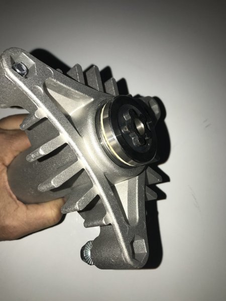

    I'd look at modifying your new spindle and bearings to take grease before they are ever used. It's alot easier when everything is clean and new.

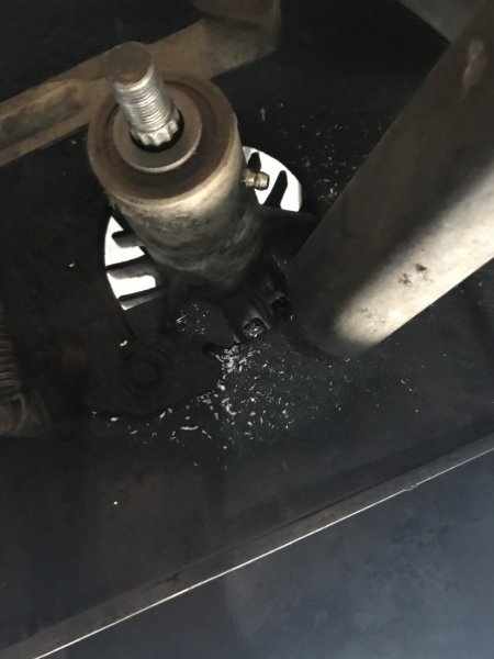

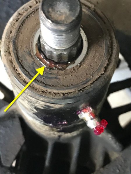

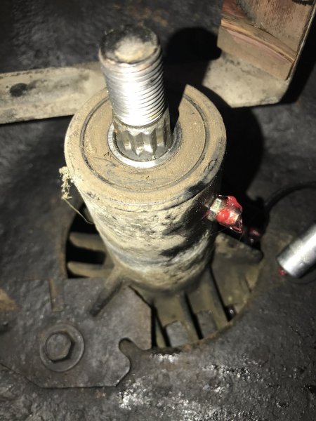

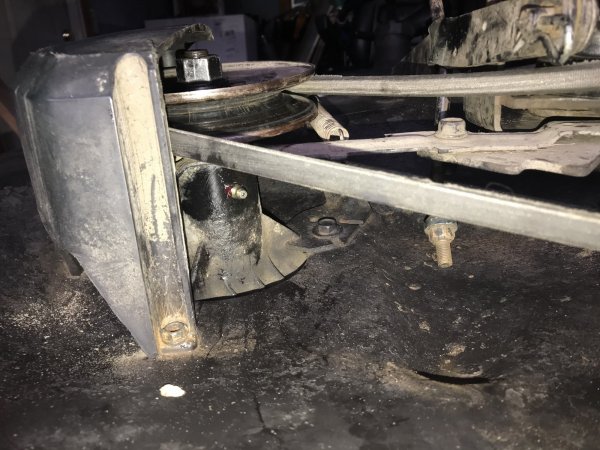

    Looks like a success!! :)
    For me it was not exactly like the video but I got more grease and started pumping until I heard a pop and the top bearing popped up ever so slightly!
    Then I saw the grease oozing out of the top seal in the top bearing! :) Bingo, time to do the other one!
    See pic below.

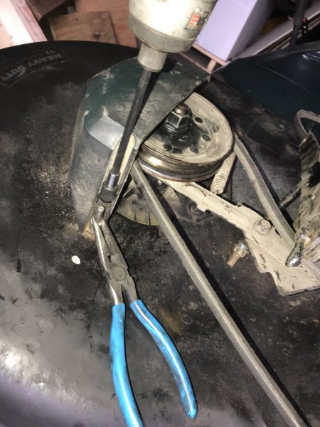

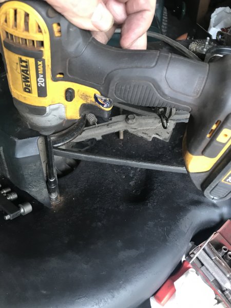

    The other side was not so easy because it has a plastic cover over the pulley! So first I had to dig out the dirt between the screw head and the cover with a small blade screwdriver! Then using a thin wall 3/8” socket and thin extension and then tap the extension with a hammer to get it onto the socket. Then the only way to get the rusty bolt out was with a DeWalt impact wrench!! LOL

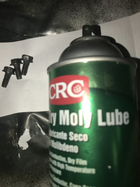

    After I got the second zerk in a started pumping grease in, I noticed the grease was getting all over the outside! Turns out the zerk was not working so I removed and replaced it and then the grease pumped on fine! Put the pulleys back on and am getting the spindle dust cover back on after wire wheeling the bolts and then spraying them with Dry Moly.
    After bolting the dust cover on with the impact driver, I had to use long nose pliers to get the Drill Driver speed Socket off the bolt head. LOL
    I did locate the zerk where I can get the grease gun on it without taking all that apart again!

    How do you remove the bearings to get to the underside to break Or remove the seals?
    Do the mandrels come out first so how do you pull those? At least a 2 ton bearing press is needed for that?
    Once the bearing is out then this vid shows if. :)
    Guess it is easier to just replace the spindles.
