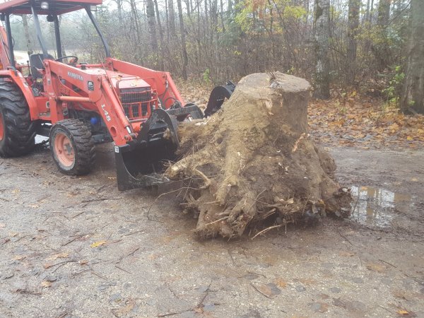

    I have a 6' rock grapple. It will just barely fit over a 28" log. I bought it for log and brush work, as well as removing broken concrete slabs. It was $1200.
    If I weren't removing concrete, i would've bought a log or brush grapple that opened wider

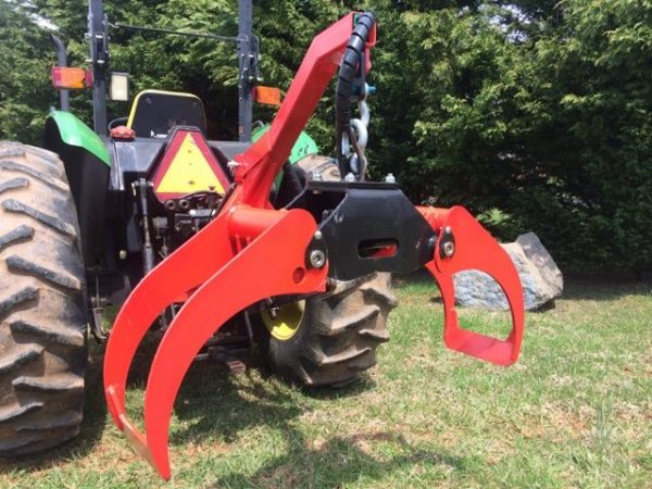

    I thought he was referring to a 3-point grapple.
