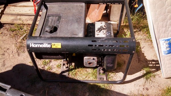

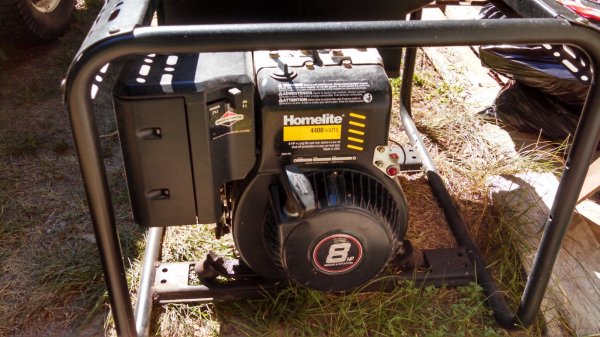

    and got it running today. Hasn't been run for a while, and it sputtered a bit, but after a few minutes, it seems to run great.
    I checked the oil first, then added fresh fuel. 5 gallon tank, but I didn't fill it.

    Forgot to mention.....he wouldn't take anything for it. Just wanted it gone.
    His loss, my gain.:thumbs:
    Wife and I have been talking about getting one of these for a while.
    Anybody know if it could handle a 1/2 HP well pump? That's our biggest problem when the power's out for any length of time.

    I've got a 5500 watt genny thats about 20 years old. I have a 3/4 HP pump at home and the generator will run it, but it dogs down a bit on startup. Knock on wood, I haven't needed to use the generator for the pump since I replaced my pressure tank with an 80 gallon one several years back. Consumers Energy did a lot of trimming here a couple years ago, and we haven't lost power nearly as much as we used to.

    If it's pumpin' 220 volts and is at least a 4000 watt unit... it should run your pump OK, though it'll lug down perty gooder. Might want to check it's voltage output under load.

    Tag says 4000 watts. 33.3 amps @ 120 volts and 16.6 amps @ 240.
    The pump motor is a 1/2 HP.
    I'm still trying to find a manual for it. Didn't think to ask BIL about that. :headbang::rofl: :lol:

    Our pump is on a 15 amp 220 breaker. If your's is too, that gen might just be able to run it. It'll be working hard while doing it probably. Obviously, you'd have to shut anything else off while running the pump. Single biggest thing to keep in mind... always give that genny 3x as much cooling air as you think it needs. The gen part of the rig can't handle high heat. Perty gooder deal ya got there bro... :yes:

    Pretty sure ours is also on a 15 amp breaker, but it's 120. Might be on a 20.
    I'd only run the well pump when we need water for flushing or if I need coffee. Especially coffee.

    I pulled the plug, and it looked like it had barely been run. Very few deposits.

    Monin Mistah... if your pump is a 120 volt unit, you should be able to run other things too on the other 16 amp leg at the same time as running the pump.
