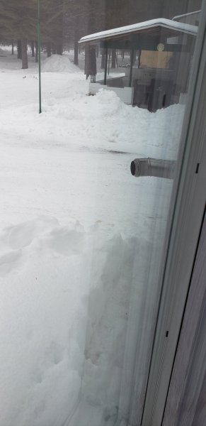

    Pp130 by pelpro. Unit seems to be fine so far. But we did have smoke spillage. Used duravent 3pvl horizontal install kit. There was some smoke coming out of the seams, mostly at the 90 elbow we had to use to put in corner and go out. Help! What should we do/ change at this point?

    ther only a short amount of pipe(1' only) going vertical inside. No other vertical. Installed on the west corner of home. Haven't used any tape yet.
    We really got stuck installing in this corner..no other spots in the house to put one.

    Well he got about 9 feet of pipe going up outside and came in and used the high temp tape. Was a little smoke at start up.
    Took side panel off and there was some smoke coming from where the adapter is on the stoves pipe.
    Doesn't help that the thing looked like someone had dropped the pallet in transit somewhere....
