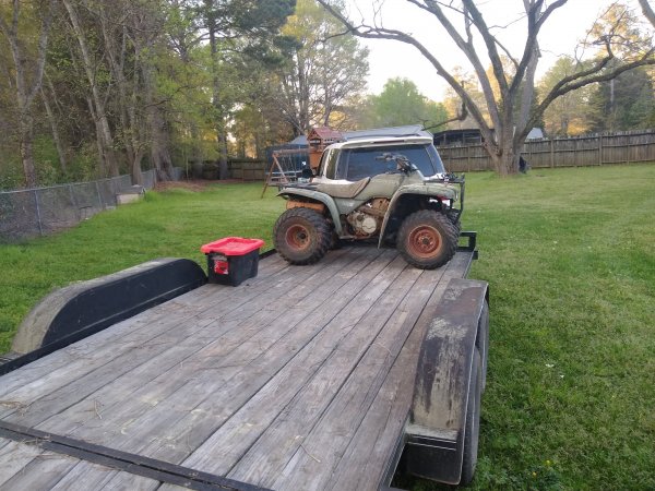

    Got this for free from my cousin. It's been sitting for I bet at least 5 years. Tank full of rust, rusted through rim. Sun killed fenders.
    I have cleaned the carb 2x, but still not right. Got a ton of rust out of the tank, wended up the rim, mounted that tire, painted that rim. I have 3 more to go now. New battery and it cranked right up. Also new petcock the old was crammed with crud. IMG_20210506_185201673.jpg IMG_20210405_191305274.jpg

    Those things are some tough ole SOB's...price was right too! :yes:

    Nice work.. Love the price.

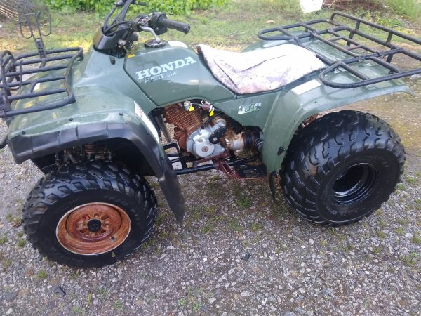

    I plan on taking a wire wheel to the racks and then putting some card board under them and painting with rust converter and then top coating with Rust-Oleum, to give the rack some protection and just better looks.
    This thing won't ever look great. Too much neglect and replacement plastic is just too expensive.
    I have been thinking of ways to make alternative flares if I chose to do so.
    I have a seat cover ordered for it. Back says Honda and sides are black and top is Camo.

    Just wondering if some car or truck fender flares might work. Saw some on amazon.

    I've seen people make them out of beltline material, or semi truck mud flaps...

    That was one thought, saw that on YouTube, also saw a guy I think mention useing that flexible garden border? And to the guy above you who posted, I had also thought about some generic roll fender flare material off eBay or Amazon and use existing mounting spots for it.
    I probably will end up getting some floor boards for this since the heal gaurds are pretty much gone and to replace just those would be about half way to floorboards. And also I think it might help my son to have a larger place to set his feet and less chance to push them off the peg accidentally.

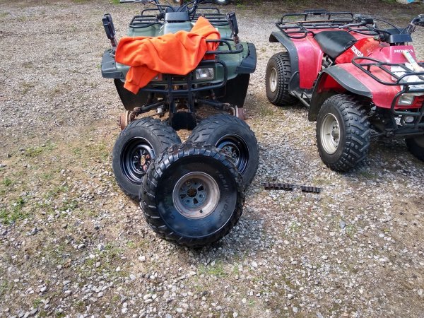

    Here is a pic of the rims after I white wheeled them and painted with Corroseal (my choice of rust converter) I like the stuff. A gallon is expensive but it goes a long way. Used in the marine industry on metal. I have some stuff done for a few years now and am pleased with results. I try to do it as best I can for quick work. Seems a quality product. Honestly the price is still cheaper than the spray can stuff and the distance it will stretch considering that stuff if $6-10 a can. And a gallon is around $50 of corroseal.
    About to put paint on the wheels now. Pulled one front brake apart. Pulled wheel cylinders apart to clean them and gone cylinder and reassemble hoping to avoid buying those. There full of crud and rust.
