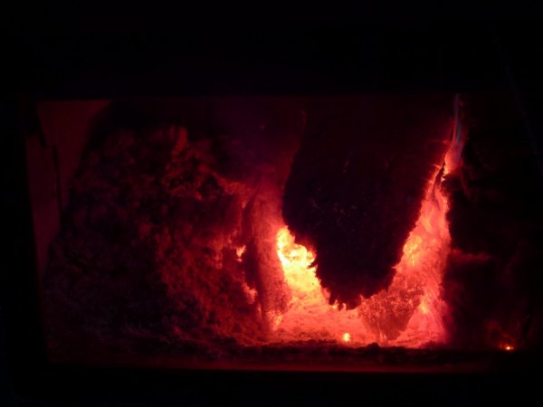

    Last year was my first with a stove, and my wood supply was marginal at best. This season I was better prepared and I had a good amount of half-decent stuff, the driest being a pile of silver maple, but with the severity of the winter I went through it much faster than expected. In December I got lucky when a neighbor had a standing dead black locust taken down. It had been dead for so long that the sapwood had mostly rotted away into something approaching soil, but it was held in place by the bark which was in turn wrapped in a mesh of English ivy. When the tree hit the ground the bark and ivy broke loose, leaving almost half a cord of barkless wood that needed a good wire brushing on the outside, but most of which metered at 14% inside.
    I burned through most of that locust in January and late February, and it was the best firewood I've had to date. I switched to other stuff during the recent thaw, so there were maybe 2-3 loads worth hanging out on my rack in the basement, the slightly damp outsides that had been in contact with the rotted sapwood drying out more thoroughly for an extra week or so. We got another wave of cold weather, so with overnight temperatures predicted to bottom out around 11F I loaded my non-cat stove N-S (as I've found works best), scraping all the coals to one side and then stuffing in as many locust splits as I could. When the top was flirting with 600F, I set the air almost completely closed and went to bed. Seven hours later I woke to find the stovetop around 450F and the fuel looking like this, still with little blue flames streaming off in back:
    This is the best burn I've had to date. I hope a drier wood supply will make it less of an anomaly next year.
