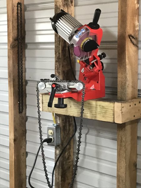

got chain grinder set up again

    got grinder set up again to try out able to reverse it time so hopefully no burr on left tooth

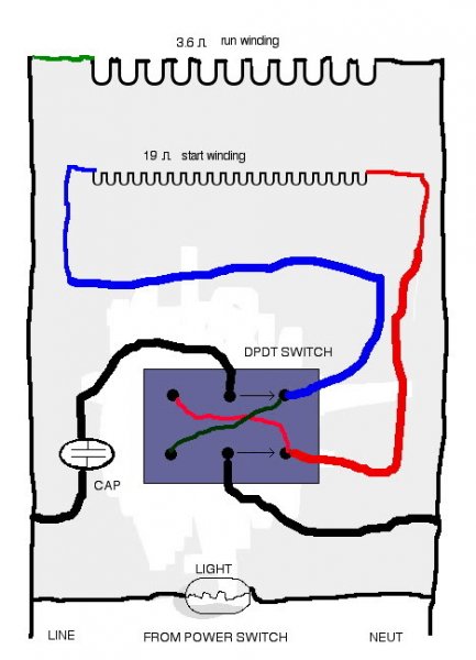

    somewhere around here i have a wiring diagram to make any of the single direction units bi-directional just need a dpdt ,co ( Double Pole Double Throw, Center Off) switch to make it work.

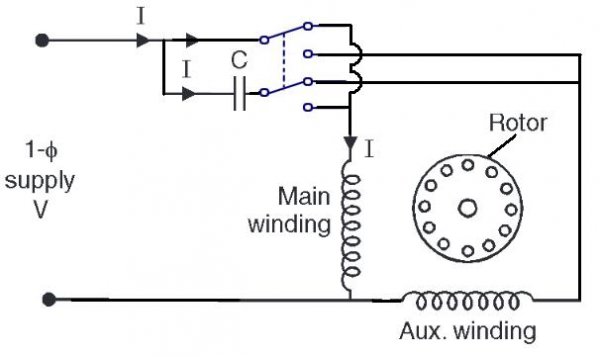

    upload_2020-3-12_17-51-0.jpeg This may help .
    Chaz, Screwloose and jmb6420 like this.
    Chaz and Screwloose like this.

    On a chain grinder can you take a DPDT CO switch and connect it into the line cord and forget the Cap. The schematic shows the cap before the switch so I am thinking it was added to the circuit and not part of the existing motor or is it needed for phase shifting and if so then what size cap do you use.

    Would that capacitor not already be in the start circuit ?
    Mag Craft, Chaz and Screwloose like this.

    i was to stupid to do it i got it to switch directions but not full power both directions so to it to shop to do it but still had put a switch to shut off or unplug to switch directions he couldn’t find a 3 pole switch that fit in where other switch was so i just wired a plug i can turn on and off

    If you just want to try it in reverse you can use an air nozzle to get it spinning in reverse then switch it on. That flimsy burr doesn't cause any issues but the crap coming towards you sucks.

    Ok I get it now. The schematic is showing the existing wiring for the motor but with a DPDT CO switch put in place of the original switch. That would work.
