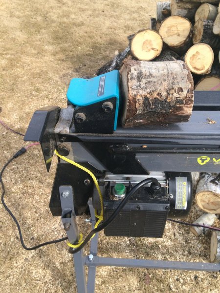

    About the only thing I might do besides cutting some 4" blocks to take up the ram slack, is add a handle with a bend to the ram activator lever. I'm not quite sure the mechanics of it yet, but it needs to pull towards a guy, and down. That way I can use one hand to lever the ram and push the power button at the same time.

    image.jpg My simple and un elegant solution to ram cycle time, and one hand use.
    Hammy likes this.

    Great idea saskwoodburner I will have to rig up a rope the next time I have mine out and running. Pretty impressed with this little guy so far. It has split all of my stringy maple that wasn't worth wacking away with the X27.

    I've only had it in use 3 times so far, but it hasn't skipped a beat yet. Made it groan a few times but haven't kicked a breaker. I know it sure saves a lot of work with unseasoned poplar (technically aspen). The little rope makes it way easier to use. Enough slack to slide your hand in easily, but not too easy, and then it's just like turning a door handle to push the button with your thumb. Then you can hold your round and make whatever perfect pieces your heart desires.:)

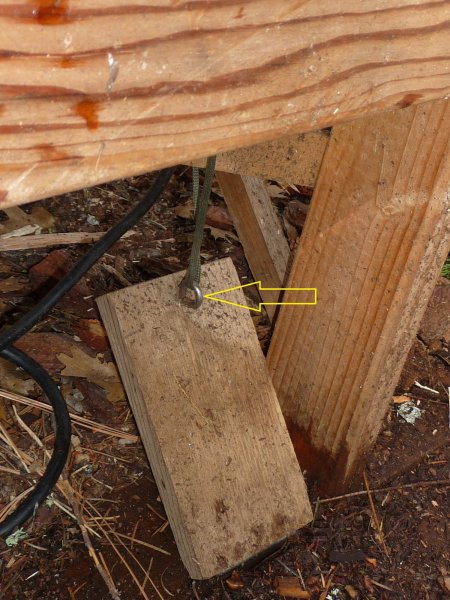

    Here's what I did with my Homelite. I've had it for over 8 years and love it.
    It looks like yours has similar controls. A 3 in. Tee hinge for the electric actuator, connected by a nylon cord thru the eye on the foot pedal and up to the hydraulic actuator.
    The foot pedal is attached to the frame with a 3 in. leaf hinge. Before I built the stand, I just had 2 individual pedals (pieces of 1x4) hanging from nylon cord.
    Here's my stroke limiter, a piece of ABS drain pipe, cut away so it is wide enough to slip over, narrow enough to snap and stay.
