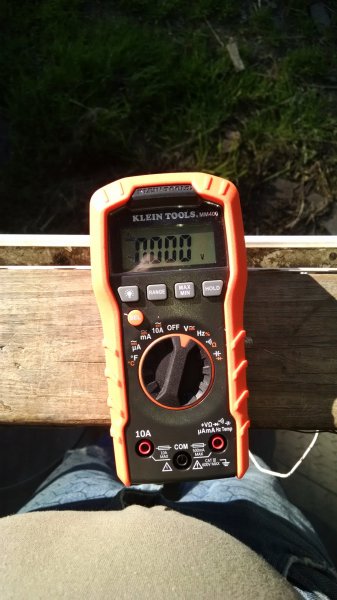

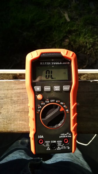

    Papadave do you have a multimeter?
    A quick check for ground is to check continuity between negative battery terminal and the chassis.
    If you can access the back of the switch, check voltage across pos n neg terminals there.

  13. Chaz
    Chaz
    Jan 27, 2018
    8,684
    61,458
    Southwestern NY
    There's likely one under the seat, and may be one on the brake system as well.
    If'n ya find your MM..
    Set for continuity..
    Set for voltage..
    You will want to make sure it's set for DC voltage. The DC symbol is the solid/dashed lines.
    Wavy line is AC

  18. Chaz
    Chaz
    Jan 27, 2018
    8,684
    61,458
    Southwestern NY
    Big word of advice I neglected earlier..
    Do not check for voltage while in continuity mode.
    :hair:
    Your meter likely has a fuse to protect it, but..
    :doh:
