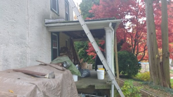

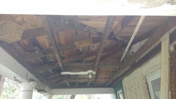

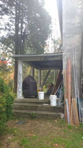

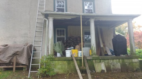

    IMG_20181102_091342302.jpg IMG_20181102_091422740.jpg IMG_20181102_091409144.jpg IMG_20181102_091533065.jpg
    Here are the pics. The poor thing is falling down, so you can see my need to get it replaced. Lots of room for improvement in the original design.

    design about normal. main problem is all that rot from leaking roofing. i see some sisterd sections indicating that somewhere in past time repairs have been attempted on the cheap. Front horizontal beam looks to be beyond saving hopefully the columns are still good . if they are wooden will have to be carefully checked for rot . There are some products that can preserve and repair those if the damage is minimal. Grand parents place the columns of a similar style were of concrete ( those things were HEAVY) It was a 2 story deal ( 2 flats circa 1930) so itwas porch on tip of a porch. complete demo and start from below grade on up. Fun summer.

    Does roof of house shed snow to that porch roof? Looks like the rafters broke when a heavy load came down and hit it which I'm betting cause the leak.

    I let the thing go for far too long, as I'd planned a complete rebuild. I'm replacing everything, including the columns. I'd like one pitch, from house to front, with as little pitch as possible.
    As I'm no carpenter or architect, I was hoping to get some information on the correct rafter size and spacing, as well as column size (I'd like them round if possible), and also for front horizontal beam. The beam is currently a box beam built up, I just want a piece of lumber when I rebuild. I'm planning on using lots of hardware, clips and hangers, to minimize stuff like Bird's mouth cuts.

    No, there are three giant cedars in front that break up the snow. They are part of the cause, as the cedar scale sticks and decomposes and holds water and clogs the gutters.
    The leaks and breaks were caused by neglect and rot. This has been a long time coming.

    I could restore it, but it would be a complete disassembly and rebuild. Plus, it's way underbuilt.
    The house is about 250 years old, the porch is probably 1950 vintage, so I could make it more historically accurate if I matched the other porch on the other side of the house.
