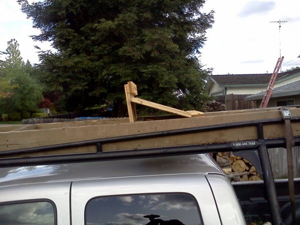

    loglift.jpg I've been using one I made for over a year. Just two boards and some blocks. My 12 year old nephew has lifted 200 pound rounds with it. I have managed to get rounds up to the tailgate that I could barely roll onto the lift, and have a bent tailgate from the drop. A 4 ft. pipe through the top end would enable a two lifters to get the really big ones.

    If you drilled holes to run a length of 3/4" pipe to use for a handle, it would be easier to grab & for me better alignment for my wrists. I would also drill holes to use finishing nails to pin the pipe to the 2x4s to keep it from spinning as you lift.

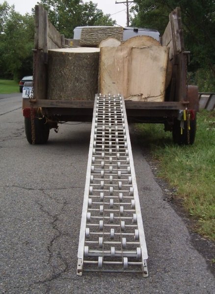

    I picked this thing up for $25. Have to block it halfway but has handled 1000 pounders without noodling (3 guys, not just me:)).

    There is a bunch of those at the local recycle center, I might have to price one next time I'm there.

    I have rollers I use in the shop. If you used a piece of plywood with rounded edges for a sled you will be able to better spread out the weight & have less problems with the round snagging. 2x2 on the edges will help to keep the round from rolling off. You could even attach a rope/chain to it so you could pull it or winch it up.
    If you use pulleys you will cut down the effort it takes. Rule of thumb is the the number of pulleys = the denominator of the fraction of weight lifted.
    - 2 pulleys = 1/2 the weight you have to lift.
    - 4 pulleys = 1/4 the weight you have to lift.
